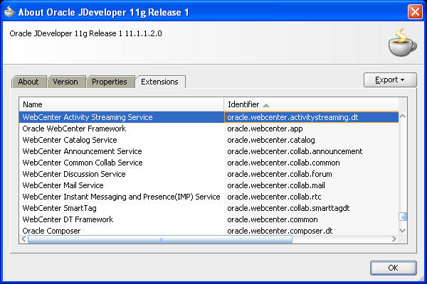

Ensure that you have installed Oracle JDeveloper 11g Release 1 (11.1.1) and the Oracle WebCenter extension (11.1.1). If you are not sure whether you have the WebCenter extension, you can verify this by opening Oracle JDeveloper, then About from the Help menu, then click the Extensions tab. At the top of the About dialog, you should see Oracle JDeveloper 11g Release 1 11.1.1.2.0. On the Extensions list, sort by Identifier to locate the oracle.webcenter.* components. Figure 2-1 shows the Oracle WebCenter components listed in JDeveloper.
Figure 2-1 Oracle WebCenter Framework in Oracle JDeveloper
Description of Figure 2-1 follows
Description of "Figure 2-1 Oracle WebCenter Framework in Oracle JDeveloper"

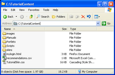

  3. Unzip the file to a local drive, such as C.
    Figure 2-2 shows the file unzipped to: C:\TutorialContent.
    Figure 2-2 Sample Content ZIP File Unzipped
    Sample content file unzipped to the C drive
    Description of "Figure 2-2 Sample Content ZIP File Unzipped "

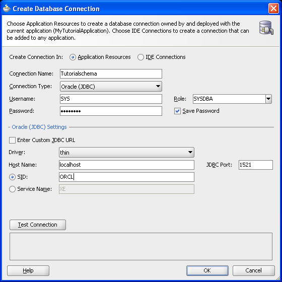

  2. In the Create Database Connection dialog, enter connection information for the system administrator of your database (Figure 2-3):
    • Connection Name: TutorialSchema
    • Connection Type: Oracle (JDBC)
    • User name: <your system administrator user ID>
    • Password: <your system administrator password>
    • Role: Choose the appropriate role from the Role list (for example, SYSDBA or SYSOPER; if using the SYSTEM user or a user that does not need the SYSDBA or SYSOPER role, then leave this field blank)
    • Host: <host name of your database> (for example, localhost)
    • JDBC Port: <port> (for example, 1521)
    • SID: <system identifier for the database with the same JDBC port> (for example, ORCL)
    Figure 2-3 Database Connection for the Tutorial Schema
    Description of Figure 2-3 follows
    Description of "Figure 2-3 Database Connection for the Tutorial Schema"
