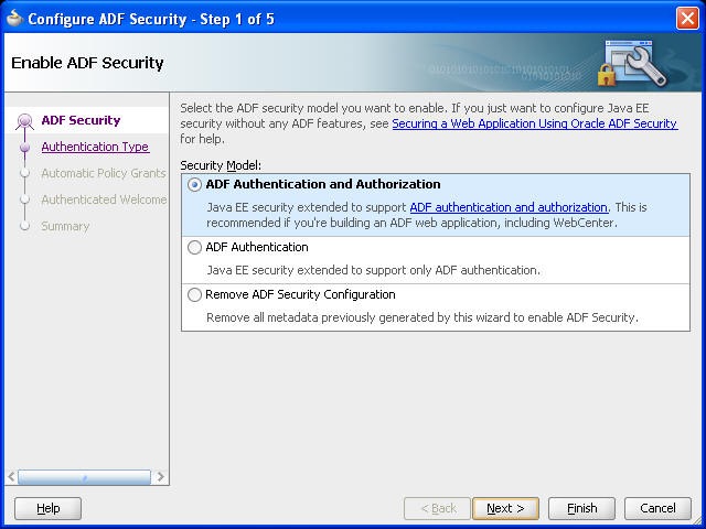

On the Enable ADF Security page, ensure ADF Authentication and Authorization is selected. Choose this option when securing any ADF web application, such as a custom WebCenter application (Figure 4-3).
Figure 4-3 Configure ADF Security - Step 1 of 5
Click Next.

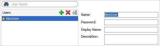

In the Users list, click the New User icon (Figure 4-8) to add a user temporarily named "NewUser" to the Users list.
While NewUser is selected, notice that the right pane updates so that you can modify the properties of the user (Figure 4-9).
In the Name field, enter Lisa.
In the password field, enter welcome1 then click on the Display Name field to make sure the password is accepted. Leave the rest of the fields blank for now.

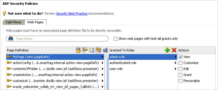

Next, add the necessary ADF Security Policies to the application. At the top of the section, click the Web Pages tab.
In the Page Definition list, click MyPage (Figure 4-16).
Figure 4-16 MyPage on the ADF Security Policies Section

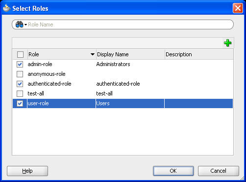

Next to the Granted To Roles column, click the Add Application Role icon.
In the Select Roles dialog, select admin-role, authenticated-role, and user-role, then click OK (Figure 4-17).
The three roles now display on the Web Pages tab of the ADF Security Policies page (Figure 4-18).

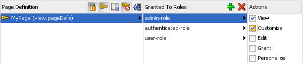

Next, assign the permissions each role has for MyPage. While admin-role is selected, under Actions, select View and Customize, as shown in Figure 4-19.
Figure 4-19 Assigning the View and Customize Actions to the admin-role
Doing so allows any user with the admin-role (in our example, Lisa) to view the page and customize it. Any customizations that Lisa makes will proliferate to the views of all users. Customizations are different from personalizations; the latter can only be viewed by the currently authenticated user.
Select the authenticated-role and ensure the role has View permissions for MyPage.
Select the user-role and select the View and Personalize actions.

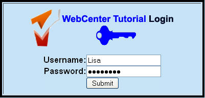

Take a look at security at runtime. Run MyPage.jspx to your browser.
In your browser, in the Username field, enter Lisa with the password welcome1 (Figure 4-34) and click Submit.
Figure 4-34 Logging into Your Application
The page displays in your browser (Figure 4-35):
