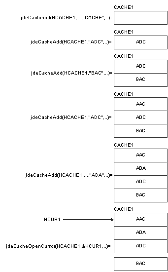

This section provides overviews of caching, JDECACHE standards, and the JDECACHE API set, and discusses how to:
Call JDECACHE APIs.
Set up indices.
Initialize the cache.
Use an index to access the cache.
Use the jdeCacheInit/jdeCacheTerminate rule.
Use the same cache in multiple business functions or forms.
Caching is a process that stores a local copy of frequently accessed content of remote objects. Caching can improve performance. JD Edwards EnterpriseOne software caches information in these ways:
The system automatically caches some tables, such as those associated with constants, when it reads them from the database at startup.
It caches these tables to a user's workstation or to a server for faster data access and retrieval.
Individual applications can be enabled to use cache.
JDECACHE APIs enable the server or workstation memory to be used as temporary storage.
JDECACHE is a component of JDEKRNL that can hold any type of indexed data that the application needs to store in memory, regardless of the platform on which the application is running; therefore, an entire table can be read from a database and stored in memory. No limitations exist regarding the type of data, size of data, or number of data caches that an application can have, other than the limitations of the computer on which it is running. Both fixed-length and variable-length records are supported. To use JDECACHE on any supported platform, you need to know only a simple set of API calls.

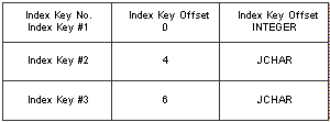

Pass that information to jdeCacheInit or jdeCacheInitEx, and JDECACHE creates this Index Definition Structure for internal use. This table lists Index Definition Structure is for STRUCT letters:
Example of an index definition structure
When you use an index to access the cache, the keys in the index that are sent to the API must correspond to the keys of the index used in the call to jdeCacheInit or jdeCacheInitEx for that cache in number, order, offset positions, and type. Therefore, if a field that was used in the index passed to jdeCacheInit or jdeCacheInitEx offsets position 99, it must also offset position 99 in the index structure that passed to JDECACHE access API.
You should use the same index structure that was used for the call to jdeCacheInit or jdeCacheInitEx whenever you call an API that requires an index structure.

The JDECACHE data set includes all of the records from the current position of the cursor to the end of the set of sequenced records. Thus, if a cursor is in the middle of the data set, none of the records in the cache prior to the current position of the cursor is considered part of the data set. The JDECACHE data set consists of the cache records sequenced in ascending order of the given index keys. This means that the order in which the records have been placed in JDECACHE is not necessarily the order in which JDECACHE Cursors retrieves them. JDECACHE Cursors retrieves records in a sequential ascending order of the index keys. A forward movement by the cursor reduces the size of the data set during sequential retrievals. When the cursor advances past the last record in the data set, a failure is returned.
This example illustrates the creation of a JDECACHE cache and a JDECACHE data set:
Example of JDECACHE cache and data set creation
