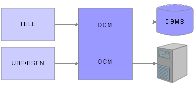

OCM Information Requests
When an application requests data from a table or a logic object for processing, OCM points to the appropriate database data source.
This diagram illustrates an information request from OCM.
