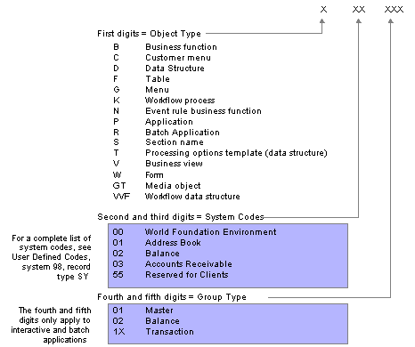

Naming Conventions for Objects
This diagram illustrates naming conventions for objects:
Naming conventions for objects
The system code is included in an object name. For a complete list of JD Edwards EnterpriseOne system codes, see UDC table 98/SY.
If you are performing JD Edwards EnterpriseOne custom work, use system codes 55 and 60-69.

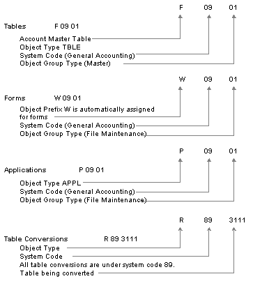

Example: Program and File Names
This diagram illustrates examples of the naming conventions for tables, forms, and applications:
Naming conventions for tables, forms, applications, and table conversions
