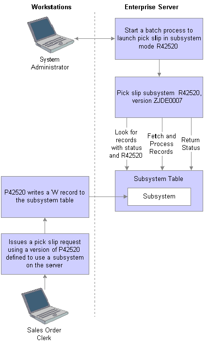

Understanding the Work With Servers Program (P986116)The Work With Servers program (P986116) in Oracle's JD Edwards EnterpriseOne provides a central location from which system administrators can monitor and control:
Server jobs
JD Edwards EnterpriseOne subsystems

Understanding JD Edwards EnterpriseOne SubsystemsWithin JD Edwards EnterpriseOne, subsystems are defined as continuously running batch jobs that run independently of, and asynchronously with, JD Edwards EnterpriseOne applications. Subsystem jobs function within the logical process of the operating system or the queue defined for the server platform. You can configure JD Edwards EnterpriseOne to use one or more subsystems.
The term subsystem is an industry-wide generic term that usually indicates a system that is a subprocess to an operating system. On iSeries server platforms, a subsystem is a logical process that is used to run system jobs, whether they are JD Edwards EnterpriseOne or other application jobs. For UNIX, JD Edwards EnterpriseOne subsystem is functionally equivalent to a daemon. On UNIX and Windows server platforms, system jobs are processed in queues; these queues are functionally equivalent to subsystems on the iSeries platform.
How JD Edwards EnterpriseOne Uses Subsystems
Some JD Edwards EnterpriseOne applications are designed to use subsystems to complete needed work. For example, you can instruct Sales Order Processing to print pick slips through a JD Edwards EnterpriseOne subsystem. You activate a subsystem through the processing options of a batch application. Then you create a specific version of the batch application, using that processing option to run the application in subsystem mode.
You must manually start subsystems to minimize the consumption of system resources. When started, JD Edwards EnterpriseOne subsystems run continuously, looking for and processing requests from JD Edwards EnterpriseOne applications. Subsystems run until you terminate them.
Typically, you use subsystem jobs running on the enterprise server to off load processor resources from the workstation. Instead of queuing requests and running them in batches at specified times of the day, you can direct the requests to a subsystem, where they are processed in realtime. For example, you might be running the Sales Order Entry application on a workstation and want to print pick slips. If you are using a version of pick slips that has the Subsystem Job function enabled, the request is executed by a subsystem job. The pick slip request is routed to and processed by the subsystem job on the defined enterprise server. As a result, no additional processing resources are required from the workstation machine to actually print the pick slip.
When an application issues a request for a job to run in a subsystem, it places a record in the Subsystem Job Master table (F986113). These records are identified by subsystem job name and contain status and operational indicators. Embedded in the record is key information that allows the subsystem to process the record without additional interaction with the requesting application. The continuously running subsystem monitors the records in this table. If the subsystem finds a record with its process ID and appropriate status indicators, it processes the record and updates the status accordingly.
This illustration displays the logical sequence of events associated with subsystems:
Logical sequence of events associated with subsystems
To prevent excessive processing overhead during server startup and to prevent unnecessary uses of processor resources for subsystem jobs that might be in use, you must manually start subsystems. Generally, the system administrator or manager-level user is responsible for this task. To manually start subsystems, a version of a JD Edwards EnterpriseOne batch process with a processing option set to enable the use of subsystems is run.
