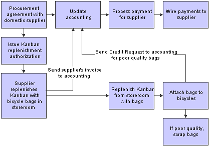

Procuring Bags from Domestic Suppliers
This graphic illustrates the process for procuring bags from domestic suppliers. Bold captions identify where cost objects are associated with activities in the procurement process.
Procuring bags from domestic suppliers

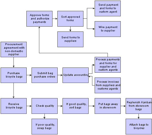

Procuring Bags from Non-domestic Suppliers
This graphic illustrates the process for procuring bags from non-domestic suppliers. Bold captions identify where cost objects are associated with activities in the procurement process.
Procuring bags from non-domestic suppliers
