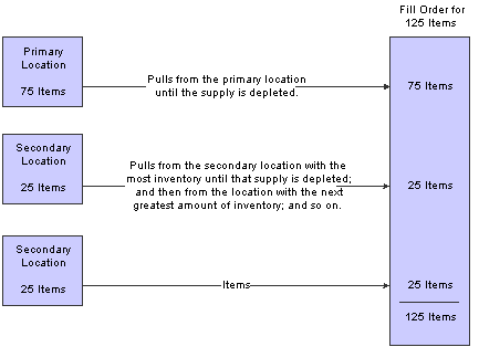

Commitments
When you set up general planning constants, you can specify whether the system uses hard or soft commitments to commit parts to a work order.
When you specify hard commitment, the system:
When you specify soft commitment, the system:
This diagram illustrates how JD Edwards EnterpriseOne Inventory Management commits inventory:
How Inventory Management commits inventory
