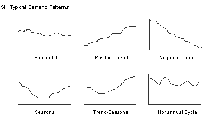

Forecast management and demand patterns.

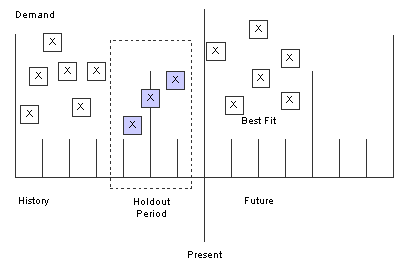

Best Fit
The system recommends the best fit forecast by applying the selected forecasting methods to past sales order history and comparing the forecast simulation to the actual history. When you generate a best fit forecast, the system compares actual sales order histories to forecasts for a specific time period and computes how accurately each different forecasting method predicted sales. Then the system recommends the most accurate forecast as the best fit. This graphic illustrates best fit forecasts:
Best fit forecast
The system uses this sequence of steps to determine the best fit:
Use each specified method to simulate a forecast for the holdout period.
Compare actual sales to the simulated forecasts for the holdout period.
Calculate the POA or the MAD to determine which forecasting method most closely matches the past actual sales.
The system uses either POA or MAD, based on the processing options that you select.
Recommend a best fit forecast by the POA that is closest to 100 percent (over or under) or the MAD that is closest to zero.

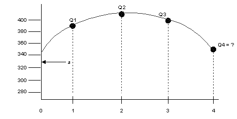

Method 7: Second Degree Approximation.

The next step involves calculating the three coefficients a, b, and c to be used in the forecasting formula Y = a + bX + cX2.
Q1, Q2, and Q3 are presented on the graphic, where time is plotted on the horizontal axis. Q1 represents total historical sales for April, May, and June and is plotted at X = 1; Q2 corresponds to July through September; Q3 corresponds to October through December; and Q4 represents January through March 2005. This graphic illustrates the plotting of Q1, Q2, Q3, and Q4 for second degree approximation:
Plotting Q1, Q2, Q3, and Q4 for second degree approximation
Three equations describe the three points on the graph:
(1) Q1 = a + bX + cX2 where X = 1(Q1 = a + b + c)
(2) Q2 = a + bX + cX2 where X = 2(Q2 = a + 2b + 4c)
(3) Q3 = a + bX + cX2 where X = 3(Q3 = a + 3b + 9c)
Solve the three equations simultaneously to find b, a, and c:
Subtract equation 1 (1) from equation 2 (2) and solve for b:
(2) – (1) = Q2 – Q1 = b + 3c
b = (Q2 – Q1) – 3c
Substitute this equation for b into equation (3):
(3) Q3 = a + 3[(Q2 – Q1) – 3c] + 9ca = Q3 – 3(Q2 – Q1)
Finally, substitute these equations for a and b into equation (1):
(1)[Q3 – 3(Q2 – Q1)] + [(Q2 – Q1) – 3c] + c = Q1
c = [(Q3 – Q2) + (Q1 – Q2)] / 2
The Second Degree Approximation method calculates a, b, and c as follows:
a = Q3 – 3(Q2 – Q1) = 370 – 3(400 – 384) = 370 – 3(16) = 322
b = (Q2 – Q1) –3c = (400 – 384) – (3 × –23) = 16 + 69 = 85
c = [(Q3 – Q2) + (Q1 – Q2)] / 2 = [(370 – 400) + (384 – 400)] / 2 = –23
This is a calculation of second degree approximation forecast:
Y =a+bX + cX2 = 322 + 85X + (–23) (X2)
When X = 4, Q4 = 322 + 340 – 368 = 294. The forecast equals 294 / 3 = 98 per period.
When X = 5, Q5 = 322 + 425 – 575 = 172. The forecast equals 172 / 3 = 58.33 rounded to 57 per period.
When X = 6, Q6 = 322 + 510 – 828 = 4. The forecast equals 4 / 3 = 1.33 rounded to 1 per period.

Forecast Management and Demand Patterns
JD Edwards EnterpriseOne Forecast Management uses sales order history to predict future demand. This section discusses:
Six typical demand patterns.
Forecast accuracy.
Forecast considerations.
Forecasting process.
Forecast methods available in JD Edwards EnterpriseOne Forecast Management are tailored for these demand patterns.
Six Typical Demand Patterns
This graphic illustrates the six typical demand patterns:
Charting six typical demand patterns
You can forecast the independent demand of information for which you have past data:
