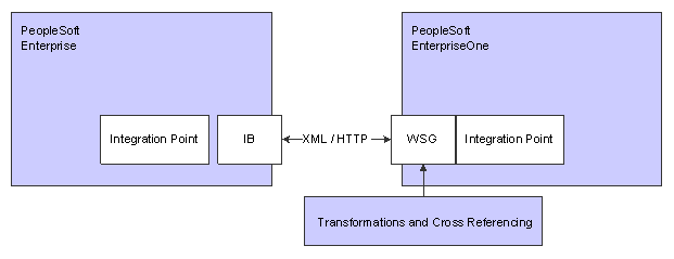

Click to jump to parent topicUnderstanding the Integration Architecture
This diagram illustrates the high level architecture for integration between the PeopleSoft Enterprise system and the JD Edwards EnterpriseOne system:
Integration Architecture diagram
The PeopleSoft Enterprise system uses integration points and Integration Broker (IB). The JD Edwards EnterpriseOne system uses WSG Integration Server (IS), which includes z-file interfaces, interface flows, and other JD Edwards EnterpriseOne integration points.
Special services have been developed using WSG Integration Server technology that map, transform, and cross-reference data as it flows between the PeopleSoft Enterprise system and the JD Edwards EnterpriseOne system. These services are written using the WSG Developer Tool.
For a detailed insight into these technologies, refer to the relevant technical implementation guides.
