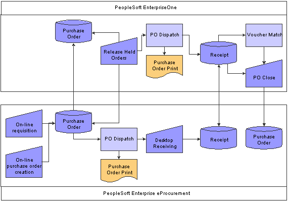

This diagram illustrates the processes supported by the integration:
PeopleSoft Enterprise eProcurement to JD Edwards EnterpriseOne Procurement process
