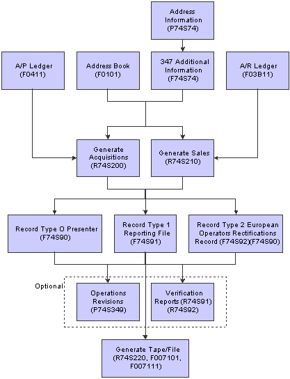

The system uses the information in the Model 347 workfiles to produce the Model 347 - Dec. Companies Report and the 347 - Operations Report. You use the Model 347 - Print Records Type 1 - Spain program (R74S71) and the Model 347 - Print Records Types 2 & 3 - Spain program (R74S72) to print these required reports. The Model 347 workfiles are also used to generate the tape file that you submit to the Spanish tax authority.
This graphic illustrates the Model 347 process:
Processing the 347 Tax Declaration

Understanding the Model 347 WorkfilesUse the Model 347 - Generate Acquisitions program (R74S100) to add information from the JD Edwards EnterpriseOne Accounts Payable system to the Model 347 workfiles. Use the 347 - Generate Sales program (R74S110) to add information from the JD Edwards EnterpriseOne Accounts Receivable system to the Model 347 workfiles.
The 347 - Generate Acquisition and 347 - Generate Sales programs summarize transactions by the customer's or supplier's tax identification number.
The 347 - Generate Acquisitions and the 347 - Generate Sales programs retrieve information from these tables to build the Model 347 workfiles:
The system populates the Zip Code field in the Model 347 workfiles based on information in the address book. For domestic customers and suppliers, the system appends three zeros to the first two digits of the customer's or supplier's zip code from the address book. For international customers and suppliers, the system uses 99 plus the customer's or supplier's three-digit country code from user-defined code (UDC) (00/CN).
You use the processing options on the 347 - Generate Acquisitions and the 347 - Generate Sales programs to specify general information that must be included on the declaration.
Important! You must define specific data selection to generate the correct information in the Model 347 workfiles. For example, you might
define the data selection based on company, GL period, and document type that correspond to a specific operation type and
class. You need to run the generation programs several times with different data selections to record information on all operation
types and classes.
You should set the processing options to regenerate the workfile only the first time that you run one of the generation programs
to clear existing information for the company and declaration year that are specified in the processing options. Whether you
run 347 - Generate Acquisitions or 347 - Generate Sales first does not matter.
