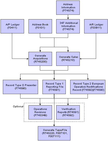

The first step in processing the Model 349 declaration is to run the Model 349 - Generate Acquisitions Records - Spain (R74S200) and the Model 349 - Generate Sales Records - Spain (R74S210) programs to generate the Model 349 workfiles.
The Model 349 workfiles consist of these tables:
F74S92 - Model 349 - Record Type 2 - Spain.
Each table contains different information according to record type.

The system uses the information in the Model 349 workfiles to produce the 349 - Dec. Companies Report (R74S91) and the 349 - Operations Report (R74S92). The model 349 workfiles are also used to generate the tape file that you submit to the Spanish tax authority.
This graphic illustrates the Model 349 process:
Processing the 349 Tax Declaration
