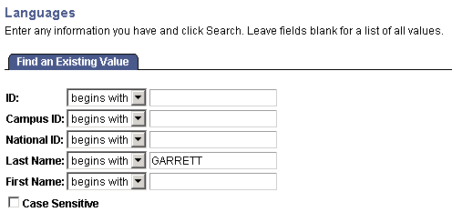

If you want to search on more fields or want to search on all of the data that you know about an individual to control the search, you can click Advanced Search and enter that data.

Entering criteria on a search box page in Advanced Search mode

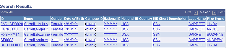

Viewing search box search results from Basic Search or Advanced Search modes
The values for theDate of Birth and National ID fields in the sample page are masked. You can choose to mask, partially mask, or fully display result field values using demographic data access (DDA) security.
