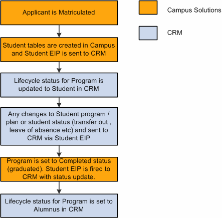

Business Process Flow Examples
The following graphics illustrate two examples of an EIP sequence as the messages move data between CS and CRM:
Example of message flow for Suspect to Applicant
Example of message flow from Applicant to Alumnus
