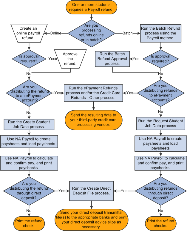

Refunding Process FlowThe following diagrams display the decisions and processes involved with creating and distributing payroll and AP refunds.
The following diagram outlines payroll refund processing:
Payroll refund process flow

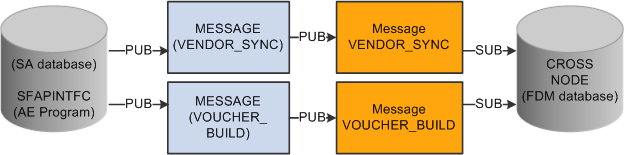

When you create refunds using the accounts payable method, you must interface with PeopleSoft Payables to complete your refunds. If your system interfaces with PeopleSoft Financials the AP Refund process publishes messages to which PeopleSoft Payables subscribes through PeopleSoft Application Messaging.
The following diagram illustrates how AP refund messages travel between Student Financials and PeopleSoft Financials
Student Financials to PeopleSoft Financials AP refund messaging process
During the AP refund messaging process, Student Financials delivers two queues and two messages to the PeopleSoft Financials database:
Message Channel |
Message |
Description |
VENDOR |
VENDOR_SYNC |
Publishes all vendor information (address, location, and contact) in a message to the PeopleSoft Financials database, one vendor at a time. Also allows changes to vendor data to be published iteratively. |
VOUCHER |
VOUCHER_BUILD |
Sends voucher header, line, and distribution information in the message to be processed by PeopleSoft Payables. The system populates staging tables with the message data. The Voucher Build (AP_VCHRBLD) process then processes these staging tables. |
