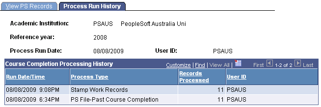

Viewing Process Run History
Access the Process Run History page (Records and Enrollment, Enrollment Reporting, AUS Regulatory Reporting, DEEWR, View Course Completion Records, Process Run History).
This page confirms the processing for the Past Course Completions extract by indicating the number of records reported and or stamped by the Submission process. The Records Processed field includes any past course completion revisions reported.
