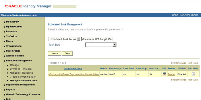

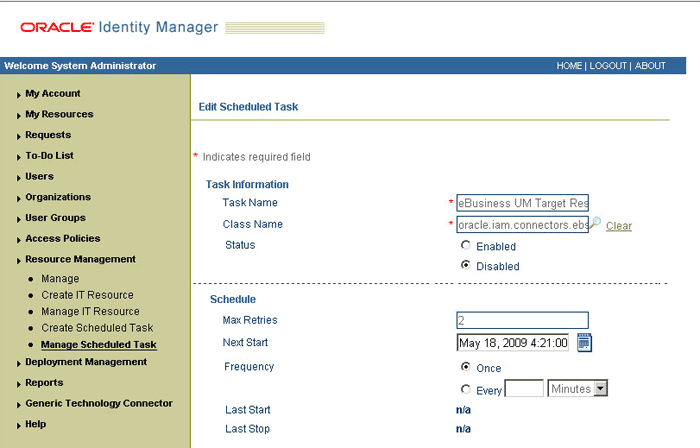

This section describes the procedure to configure scheduled tasks. You can apply this procedure to configure the scheduled tasks for lookup field synchronization and reconciliation.
To configure a scheduled task:
Log in to the Administrative and User Console.
Expand Resource Management.
Click Manage Scheduled Task.
On the Scheduled Task Management page, enter the name of the scheduled task as the search criteria and then click Search.
The following screenshot shows the Scheduled Task Management page:
In the search results table, click the edit icon in the Edit column for the scheduled task. The following screenshot shows the Scheduled Task Details page:
On the Edit Scheduled Task Details page, you can modify the following details of the scheduled task by clicking Edit:
Status: Specify whether or not you want to leave the task in the enabled state. In the enabled state, the task is ready for use.
Max Retries: Enter an integer value in this field. This number represents the number of times Oracle Identity Manager must attempt to complete the task before assigning the ERROR status to the task. The default value is 2.
Next Start: Use the date editor to specify the date when you want the task to run. After you select a date value in the date editor, you can modify the time value that is automatically displayed in the Next Start field.
Frequency: Specify the frequency at which you want the task to run.
When you click Edit, the Edit Scheduled Task page is displayed.
After modifying the values for the scheduled task details listed in the previous step, click Continue.
Specify values for the attributes of the scheduled task. To do so, select each attribute from the Attribute list, specify a value in the field provided, and then click Update.
The following screenshot shows the Attributes page. The attributes of the scheduled task that you select for modification are displayed on this page.
Click Save Changes to commit all the changes to the database.
Note: If you want to stop a scheduled task while it is running, then use the Stop Execution feature of the Design Console. See the "The Task Scheduler Form" section in Oracle Identity Manager Design Console Guide for information about this feature. |

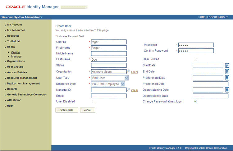

If you select Create, on the Create User page, enter values for the OIM User fields and then click Create User. The following screenshot shows the Create User page:

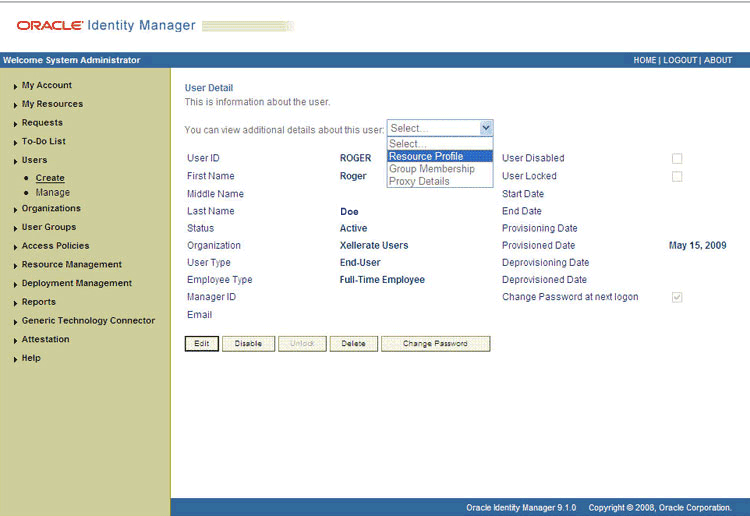

If you select Manage, then search for the OIM User and select the link for the user from the list of users displayed in the search results.

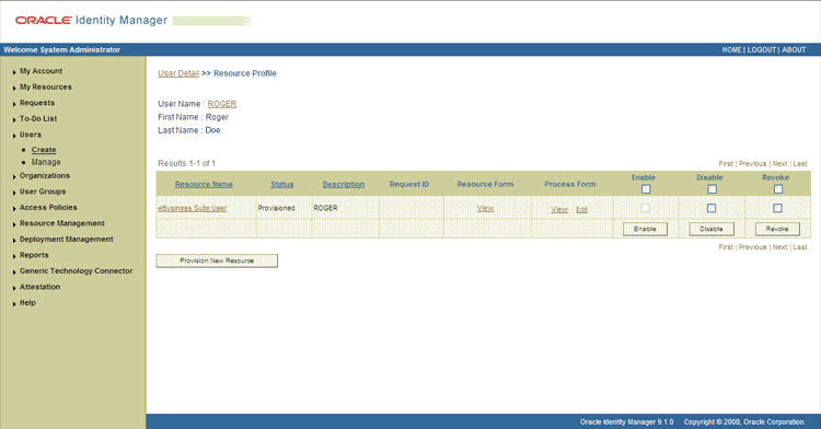

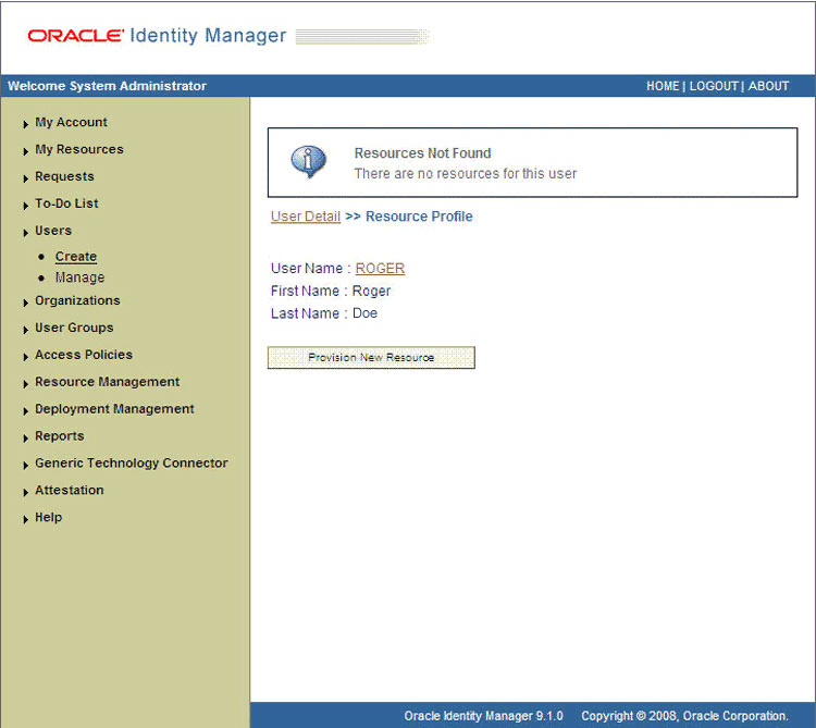

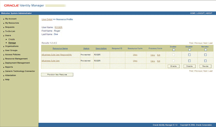

On the User Detail page, select Resource Profile from the list at the top of the page. The following screenshot shows the User Detail page.
On the Resource Profile page, click Provision New Resource. The following screenshot shows the Resource Profile page.

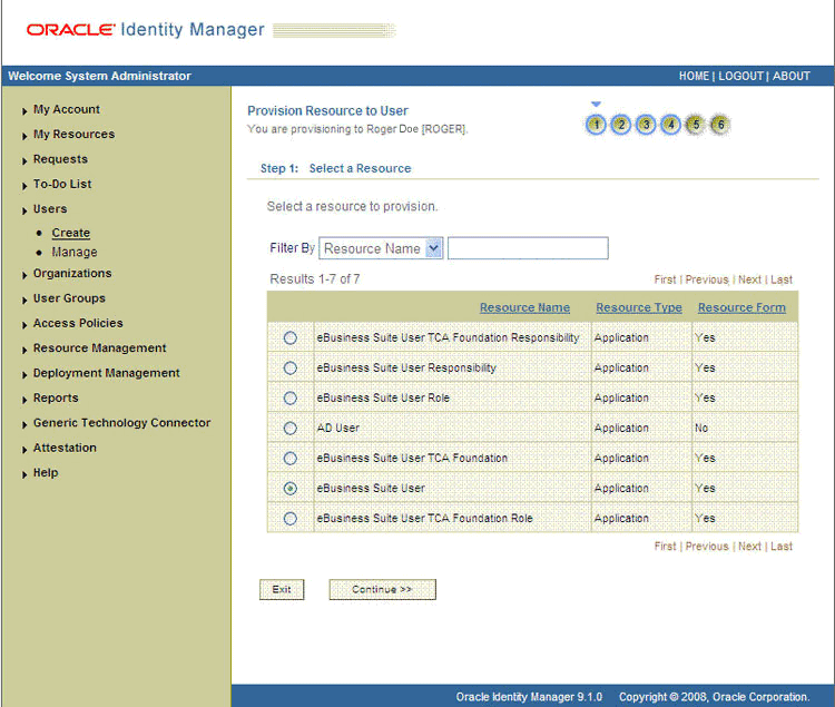

On the Step 1: Select a Resource page, select the resource that you want to provision from the list and then click Continue. The following screenshot shows the Step 1: Select a Resource page.
On the Step 2: Verify Resource Selection page, click Continue. The following screenshot shows the Step 2: Verify Resource Selection page.

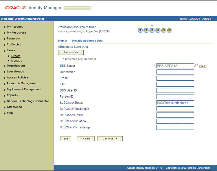

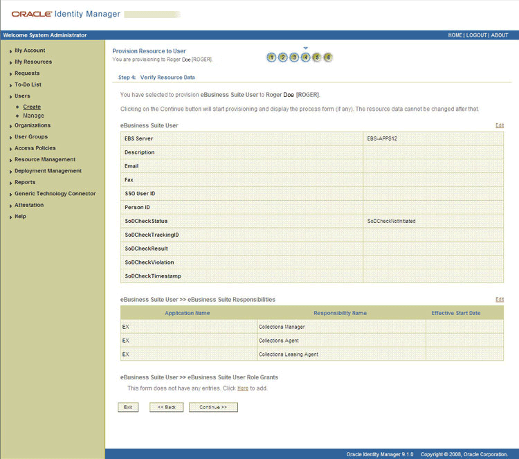

On the Step 3: Provide Resource Data page for process data, enter the details of the account that you want to create on the target system and then click Continue. The following screenshot shows the user details added.

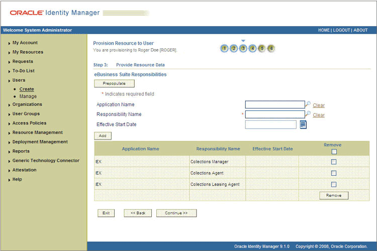

On the Step 3: Provide Process Data page for responsibility data, specify the application name, responsibility name, and effective start date for the account and then click Add. If you want to add more than one responsibility, repeat the process. Then, click Continue. The following screenshot shows this page:
On the Step 3: Provide Process Data page for role data, specify the application name, role name, and start date for the role assignment and then click Add. If you want to add more than one role, repeat the process. Then, click Continue. The following screenshot shows this page:
On the Step 4: Verify Process Data page, verify the data that you have provided and then click Continue. The following screenshot shows Step 4: Verify Process Data page.
The "Provisioning has been initiated" message is displayed. Click Back to User Resource Profile. The Resource Profile page shows that the resource has been provisioned to the user. The following screenshot shows this page:

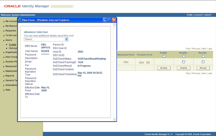

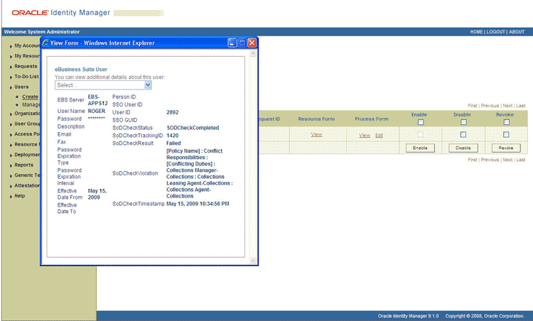

If you click the View link in the Process Form column, then the process form is displayed. The following screenshot shows this page:
In this screenshot, the SODCheckStatus field shows SODCheckPending. The value in this field can be SoDCheckResultPending or SoDCheckCompleted.
Note: If Oracle Identity Manager is not SoD enabled, then then SOD Check Status field shows SODCheckNotInitiated. |

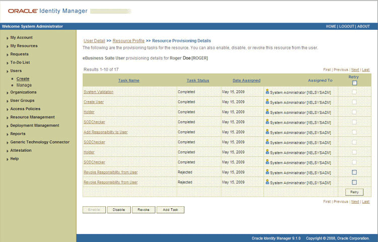

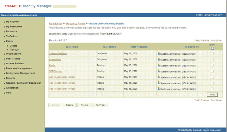

If you click the resource, then the Resource Provisioning Details page is displayed. The following screenshot shows this page:
This page shows the details of the process tasks that were run. The Holder and SODChecker tasks are in the Pending state. These tasks will change state after the status of the SoD check is returned from the SoD engine. The Add Responsibility and Add Role to User tasks correspond to the responsibilities and roles selected for assignment to this user.
Note: SoD validation by Oracle Application Access Controls Governor is asynchronous. The validation process returns a result as soon as it is completed. |

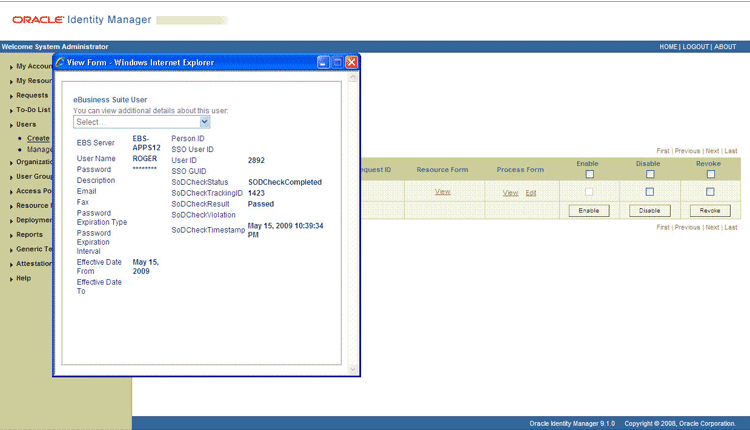

After the Get SOD Check Results Provisioning scheduled task is run, the results of the SoD validation process are brought to Oracle Identity Manager. If you click the View link in the Process Form column, then the process form is displayed. The following screenshot shows this page:
In this screenshot, the SOD Check Status field shows SoDCheckCompleted. Because a violation by the SoD engine in this particular example, the SoD Check Violation field shows the details of the violation.

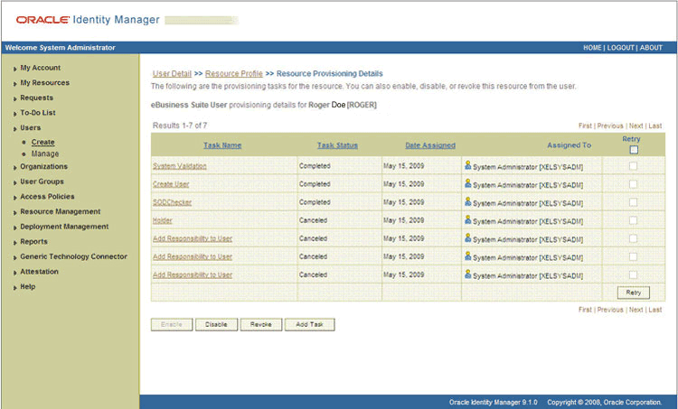

In addition, the Resource Provisioning Details page shows the status of the SODChecker and Holder tasks as Completed.
In this screenshot, the status of the Add User Role tasks is Canceled because the request failed the SoD validation process.

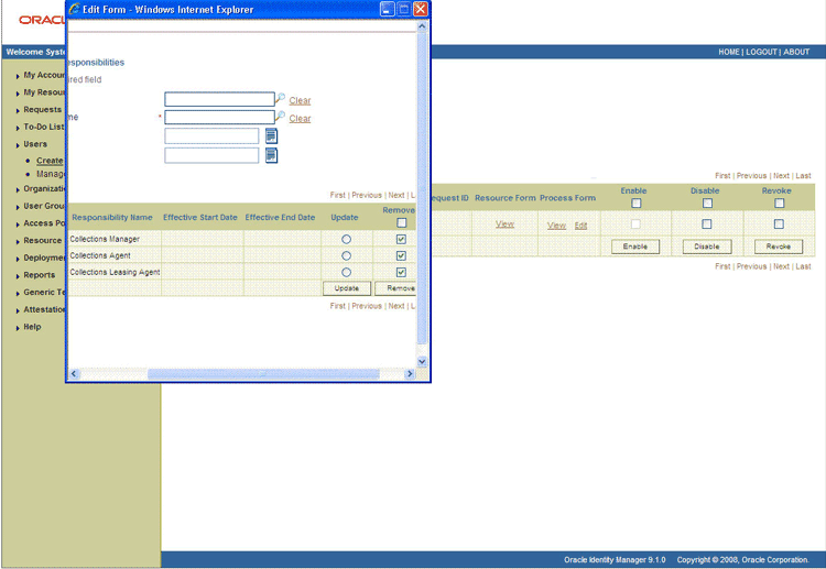

As the administrator assigning a resource to a user, you can either end the process when a violation is detected or modify the assignment data and then resend it. To modify the assignment data, first click the Edit link in the Process Form column on the Resource Profile page.
In the Edit Form window that is displayed, you can modify the role and profile data that you had selected earlier.
Note: To modify a set of entitlements In the Edit Form window, you must first remove all entitlements and then add the ones that you want to use. |
In the following screenshot, one of the roles selected earlier is marked for removal:

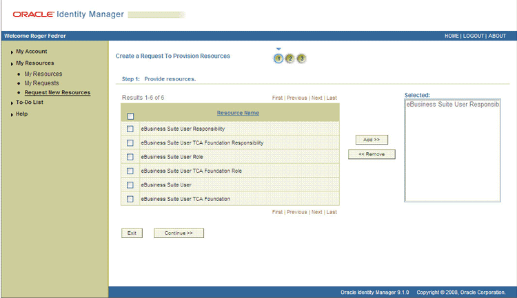

Expand My Resources, and then click Request New Resources.
On the Step 1: Provide resources page, use the Add button to select one of the following:
eBusiness Suite User, if you want to create a request for a target system account
eBusiness Suite User Responsibility or eBusiness Suite User Role, if you want to create a request for an entitlement on the target system
The following screenshot shows the eBusiness Suite User Responsibility entitlement selected:

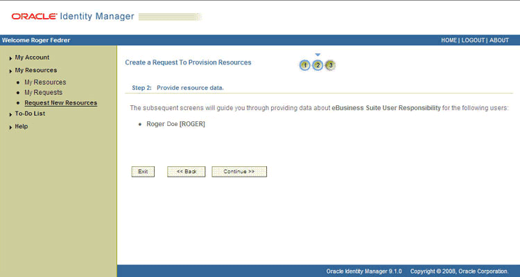

On the Step 2: Provide resource data page, click Continue.

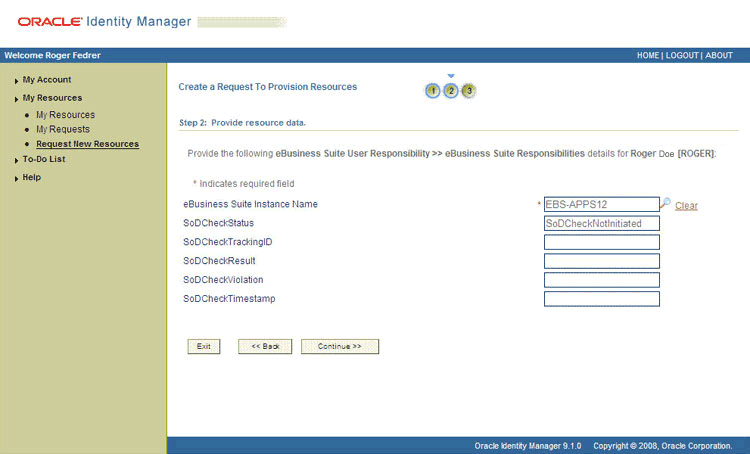

On the second Step 2: Provide resource data page, select the IT resource corresponding to the target system installation on which you want the selected entitlement.

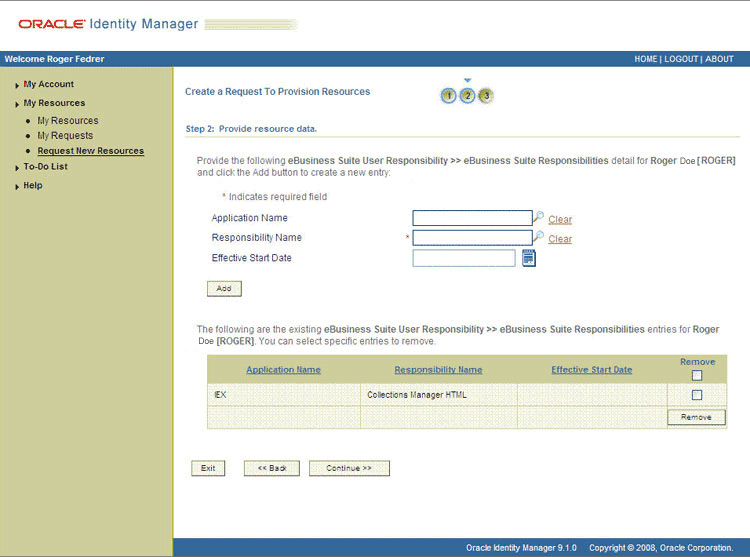

On the third Step 2: Provide resource data page, to add the responsibility data, specify the application name, responsibility name and effective start date for the responsibility and then click Add. If you want to add more than one responsibility, repeat the process. Then, click Continue.
The following screenshot shows two roles selected on this page:

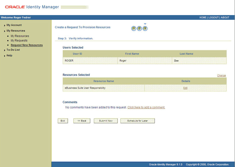

On the Step 3: Verify information page, review the information that you have provided and then submit the request. The following screenshot shows this page:

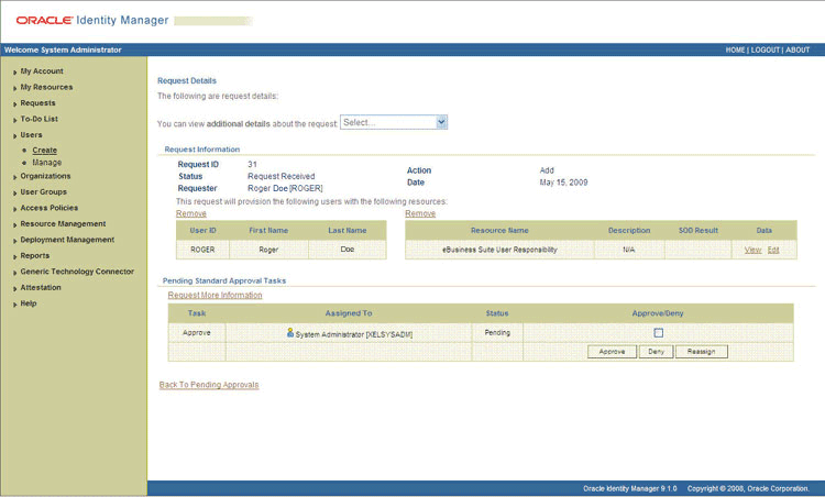

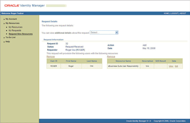

If you click Submit Now, then the Request Submitted page shows the request ID. The following screenshot shows this page:
If you click the request ID, then the Request Details page is displayed. The following screenshot shows this page:
Note: If Oracle Identity Manager is not SoD enabled, then the SOD Check Status field shows SODCheckNotInitiated. |

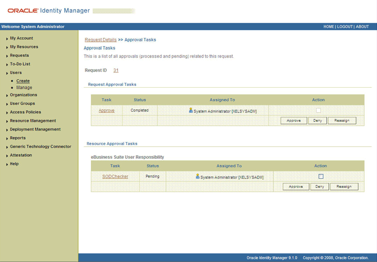

To view details of the approval, select Approval Tasks from the list at the top of the page. The Approval Tasks page is displayed. The following screenshot shows this page:
On this page, the status of the SODChecker task is Pending.
To initiate SoD validation of pending entitlement requests, the approver must run the Get SOD Check Results Approval scheduled task.
After the Get SOD Check Results Approval scheduled task is run, on the Approvals Task page, the status of the SODChecker task is Completed and the Approval task status is Pending. This page also shows details of the administrator who must now approve the request.
The following screenshot shows the Approvals Task page after the request passes the SoD validation process.

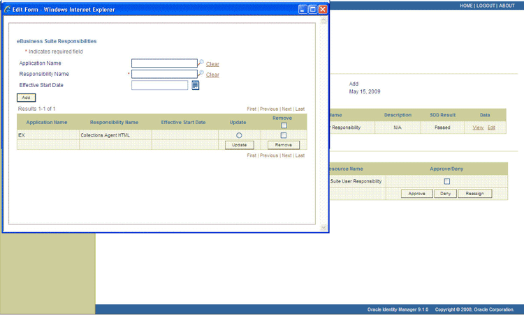

As the approver, to edit and approve a request, click the Edit link.
In the Edit Form window, select the entitlement request data that you want to modify from the list at the top of the window and then make the required change. In the following screenshot, one of the roles that the requester had included in the request has been removed:
Close the Edit Form window, select the check box for the task that you want to approve, and then click Approve.
On the Confirmation page, click Confirm.
