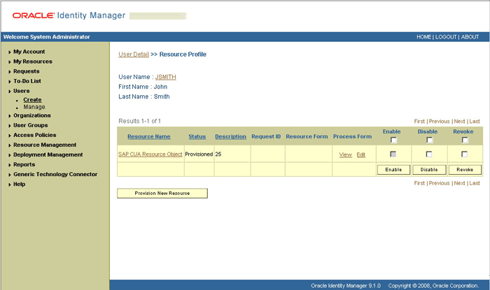

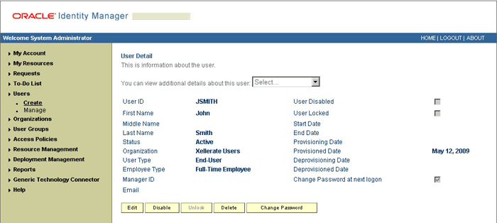

On the User Detail page, select Resource Profile from the list at the top of the page. The following screenshot shows the User Detail page:
On the Resource Profile page, click Provision New Resource. The following screenshot shows the Resource Profile page:

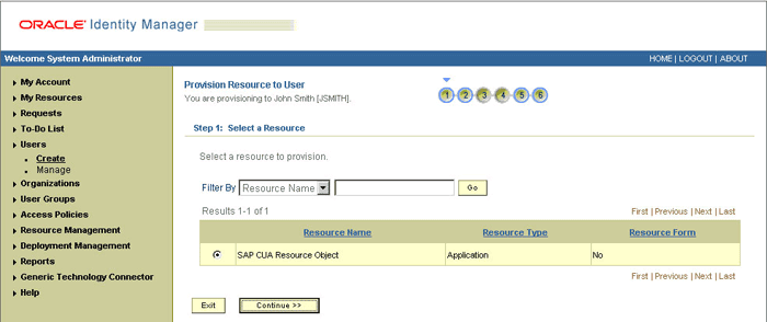

On the Step 1: Select a Resource page, select SAP CUA Resource Object from the list and then click Continue. The following screenshot shows the Step 1: Select a Resource page:

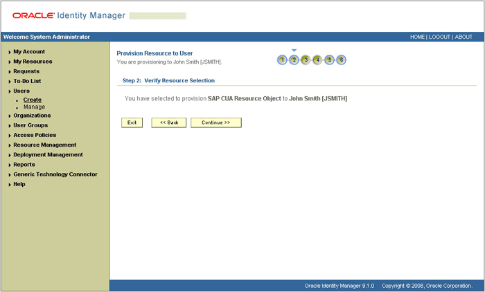

On the Step 2: Verify Resource Selection page, click Continue. The following screenshot shows the Step 2: Verify Resource Selection page:

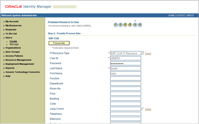

On the Step 5: Provide Process Data page for process data, enter the details of the account that you want to create on the target system and then click Continue. If you are setting values for the Terminal Services Profile fields, then you must select the Remote Manager IT resource. The following screenshot shows the user details added:

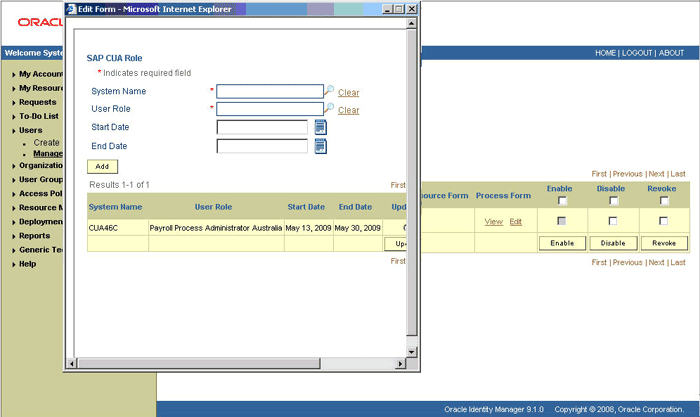

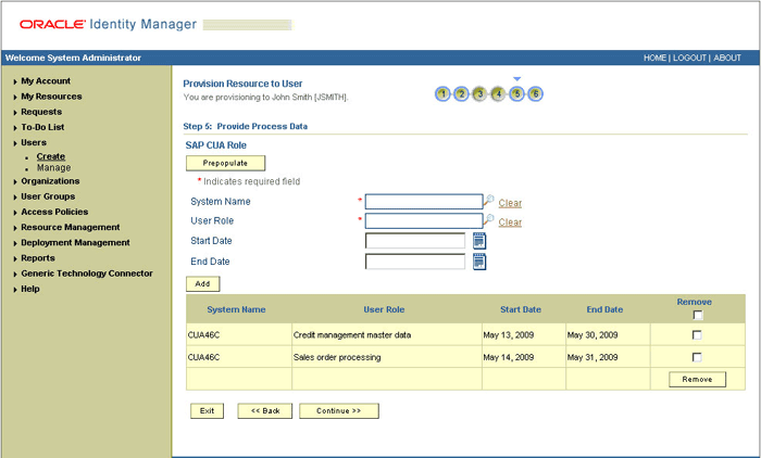

On the Step 5: Provide Process Data page for role data, search for and select profiles for the user on the target system and then click Continue. The following screenshot shows this page:
On the Step 5: Provide Process Data page for role data, search for and select roles for the user on the target system and then click Continue. The following screenshot shows this page:

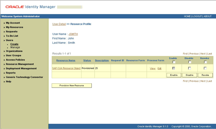

The "Provisioning has been initiated" message is displayed. Click Back to User Resource Profile. The Resource Profile page shows that the resource has been provisioned to the user:

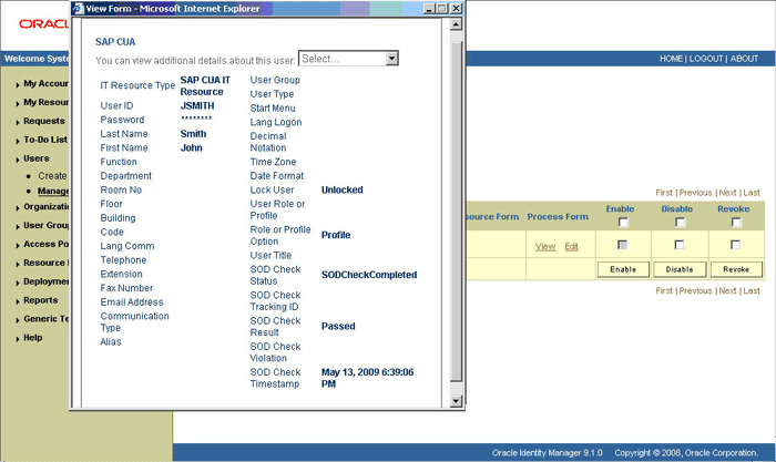

If you click the View link in the Process Form column, then the process form is displayed. The following screenshot shows this page:

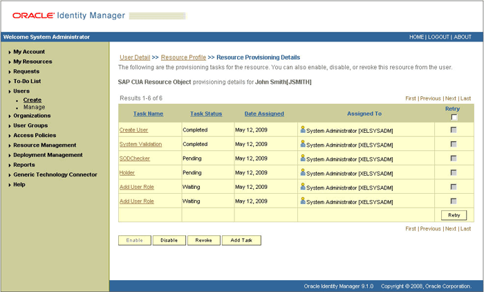

In this screenshot, the SOD Check Status field shows SODCheckNotInitiated. The value in this field can be SoDCheckNotInitiated, SoDCheckResultPending, or SoDCheckCompleted.
If you click the resource, then the Resource Provisioning Details page is displayed. The following screenshot shows this page:
This page shows the details of the process tasks that were run. The Holder and SODChecker tasks are in the Pending state. These tasks will change state after the status of the SoD check is returned from the SoD engine. The Add User Role tasks correspond to the two roles selected for assignment to this user.
The SODCheckNotInitiated status in the SOD Check Status field indicates that SoD validation has not started. To start SoD validation, you must run the Resubmit Uninitiated Provisioning SOD Checks scheduled task.

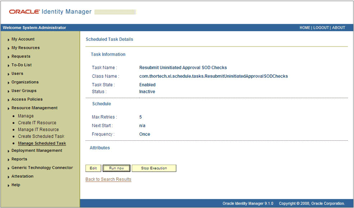

The following screenshot shows the Resubmit Uninitiated Provisioning SOD Checks scheduled task:
After the Resubmit Uninitiated Provisioning SOD Checks scheduled task is run, the results of the SoD validation process are brought to Oracle Identity Manager. If you click the View link in the Process Form column, then the process form is displayed. The following screenshot shows this page:
In this screenshot, the SOD Check Status field shows SoDCheckCompleted. Because a violation by the SoD engine in this particular example, the SoD Check Violation field shows the details of the violation.
In addition, the Resource Provisioning Details page shows the status of the SODChecker and Holder tasks as Completed.
In this screenshot, the status of the Add User Role tasks is Canceled because the request failed the SoD validation process.

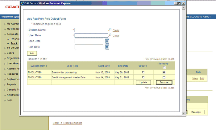

In the Edit Form window that is displayed, you can modify the role and profile data that you had selected earlier.
Note: To modify a set of entitlements in the Edit Form window, you must first remove all entitlements and then add the ones that you want to use. |
In the following screenshot, one of the roles selected earlier has been removed:
In this screenshot, the SOD Check Status field shows SoDCheckCompleted. Because the SoD engine does not detect any violation, the SoD Check Violation field shows Passed
On the Resource Provisioning Details page, the state of the Add User Role task is Completed.

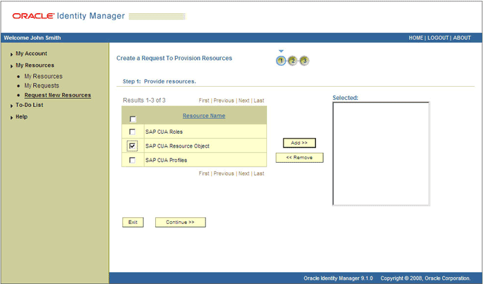

Log in to the Administrative and User Console.
Expand My Resources, and then click Request New Resources.
On the Step 1: Provide resources page, use the Add button to move one of the following:
SAP CUA Resource Object, if you want to create a request for a target system account
SAP CUA Roles and SAP CUA Profiles, if you want to create a request for an entitlement on the target system
The following screenshot shows the SAP CUA resource object selected:

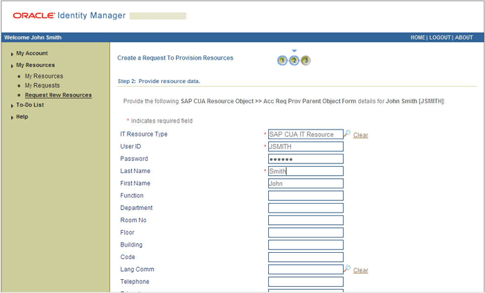

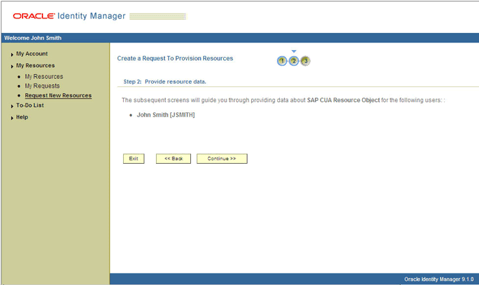

On the Step 2: Provide resource data page, and click Continue.

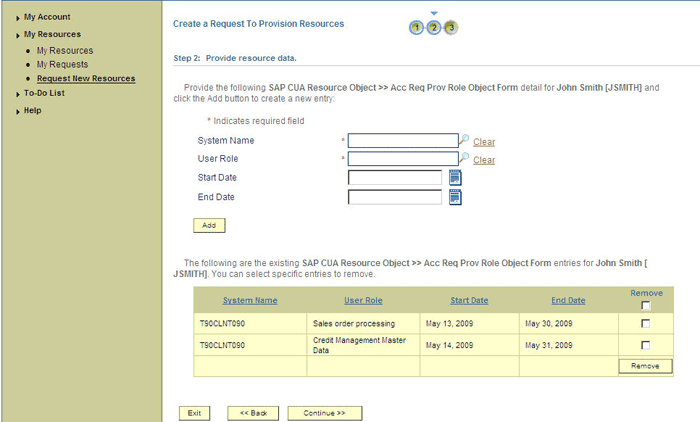

On the second Step 2: Provide resource data page, select the IT resource corresponding to the target system installation and other attribute values on which you want the selected account.
On the third Step 2: Provide resource data page, select the entitlements that you want to request.
The following screenshot shows two roles selected on this page:

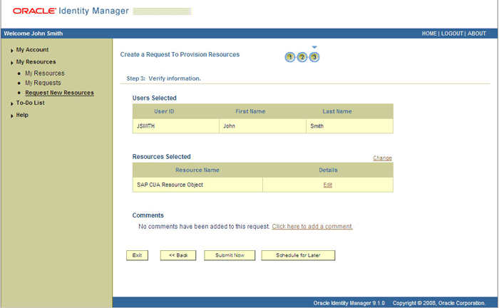

On the Step 3: Verify information page, review the information that you have provided and then submit the request.

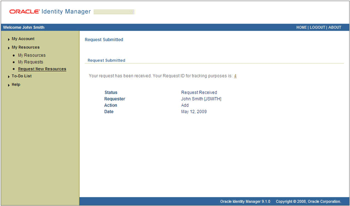

If you click Submit Now, then the Request Submitted page shows the request ID.

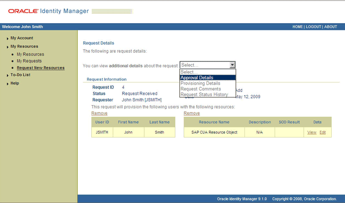

If you click the request ID, then the Request Details page is displayed.
The SOD Status field shows SODCheckNotInitiated. The value in this field can be SoDCheckNotInitiated, SoDCheckResultPending, or SoDCheckCompleted.

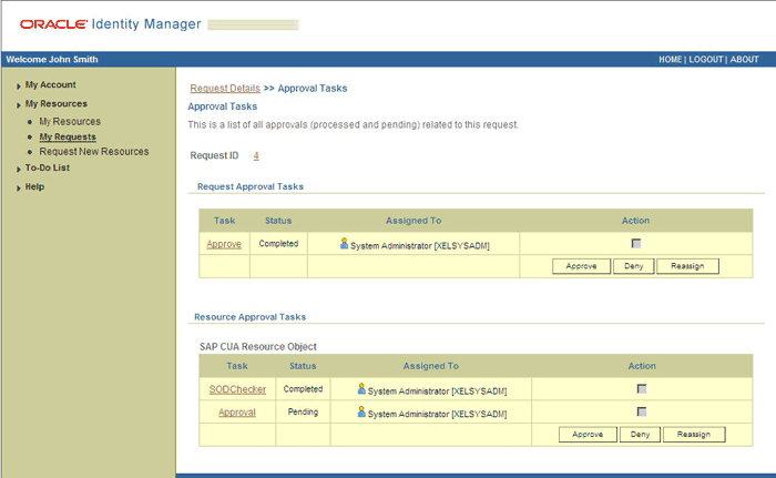

To view details of the approval, select Approval Tasks from the list at the top of the page. The Approval Tasks page is displayed. The following screenshot shows this page:
On this page, the status of the SODChecker task is Pending.
To initiate SoD validation of pending entitlement requests, an administrator must run the Resubmit Uninitiated Approval SOD Checks scheduled task.
After the Resubmit Uninitiated Approval SOD Checks scheduled task is run, on the Approvals Task page, the status of the SODChecker task is Completed and the Approval task status is Pending. This page also shows details of the administrator who must now approve the request.
The following screenshot shows the Approvals Task page after the request passes the SoD validation process:

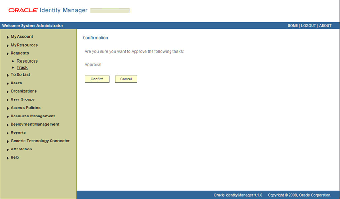

Close the Edit Form window, select the check box for the task that you want to approve, and then click Approve.
On the Confirmation page, click Confirm.

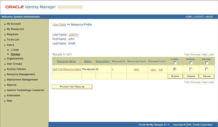

On the Request Details page, the SOD Status column shows SODCheckCompleted.
If you search for and open the requester's profile, the SAP CUA resource object is shown in the Provisioned state. This is shown in the following screenshot:
