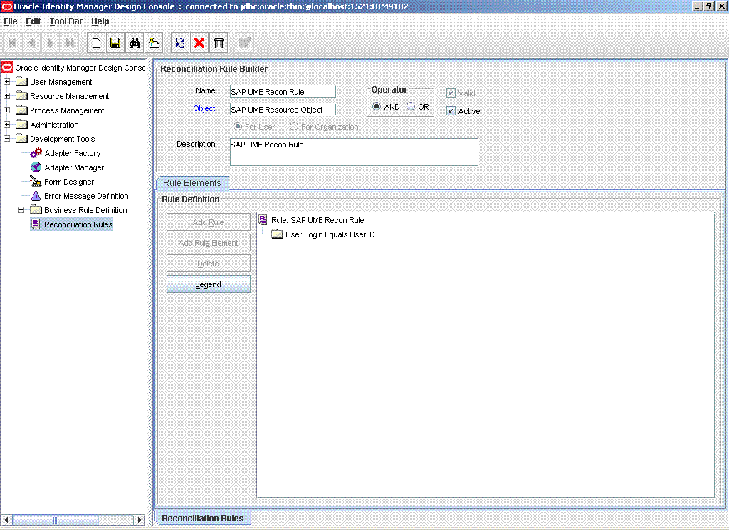

The following sections provide information about the reconciliation rules for this connector:
The following is the process-matching rule:
Rule name: SAP UME Recon Rule
Rule element: User Login Equals User ID
In this rule element:
User Login is the User ID field of the OIM User form.
User ID is the user ID of the SAP account.
After you deploy the connector, you can view the reconciliation rule for reconciliation by performing the following steps:
Note: Perform the following procedure only after the connector is deployed. |
Log in to the Oracle Identity Manager Design Console.
Expand Development Tools.
Double-click Reconciliation Rules.
Search for and open the SAP UME Recon Rule rule. Figure 1-2 shows this reconciliation rule.
Note: No action is performed for rule conditions that are not predefined for this connector. You can define your own action rule for such rule conditions. See Oracle Identity Manager Design Console Guide for information about modifying or creating reconciliation action rules. |

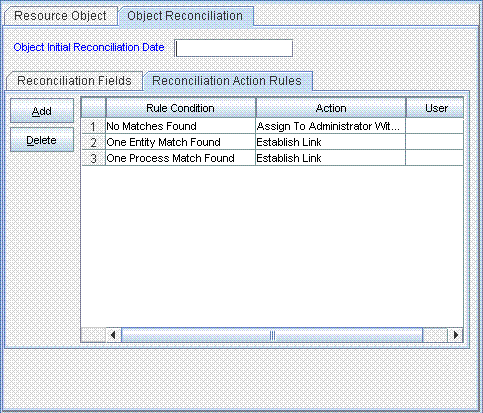

Table 1-6 lists the action rules for reconciliation.
After you deploy the connector, you can view the reconciliation action rules for reconciliation by performing the following steps:
Expand Resource Management, and double-click Resource Objects.
If you want to view the reconciliation action rules for reconciliation, then search for and open the SAP UME Resource Object resource object.
Click the Object Reconciliation tab, and then click the Reconciliation Action Rules tab. The Reconciliation Action Rules tab displays the action rules defined for this connector. Figure 1-3 shows the reconciliation action rules for reconciliation.
