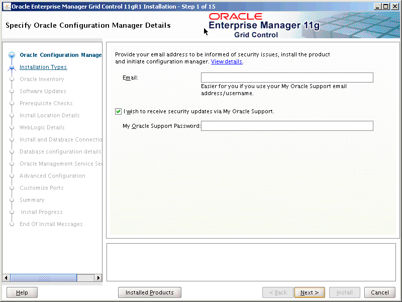

3.2.3.1 Using My Oracle Support User Name and Password (No Parameters Used)
<ocm_install_root>/ccr/bin/setupCCR
Provide your email address to be informed of security issues, install and
initiate Oracle Configuration Manager. Easier for you if you use your My Oracle Support
Email address/User Name.
Visit http://www.oracle.com/support/policies.html for details.
Email address/User Name: jsmith@example.com
Provide your My Oracle Support password to receive security updates via your My Oracle Support account.
Password (optional):

3.3 Installing Oracle Configuration Manager Using the Oracle Universal Installer
Oracle Configuration Manager may be bundled with another product release or patchset, and can be installed using the Oracle Universal Installer. When you are installing the product release or patchset with which Oracle Configuration Manager has been included, Figure 3-1 is displayed.
Figure 3-1 Oracle Configuration Manager Registration Screen
Surrounding text describes Figure 3-1 .
3.3.1 Providing Credentials
When you provide both the e-mail address and password, Oracle Configuration Manager checks for connectivity to verify the credentials specified. If there is no direct connectivity to Oracle, the Connection Failed dialog box appears with the Proxy connection method selected (Figure 3-2). If you want to configure Oracle Configuration Manager to connect to Oracle using an Oracle Support Hub, you must select the Oracle Support Hub radio button (Figure 3-3). Either of these methods enable you to define a connection to Oracle.
If no connection is possible, check the I want to remain uninformed of critical security issues in my configuration check box on the Connection Failed dialog box. This causes Oracle Configuration Manager to be installed in disconnected mode.
Once connectivity is established, the credentials are verified. You are given three opportunities to enter correct credentials. After the third failure, you will no longer be prompted and Oracle Configuration Manager will be configured in unauthenticated mode.
You must supply at least the e-mail address. Oracle Configuration Manager is configured in unauthenticated mode.
