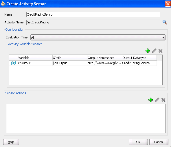

To configure an activity sensor:
Assume you are monitoring a loan flow application, and want to know the following:
When a scope named GetCreditRating is initiated
When it is completed
At completion, what is the credit rating for the customer
The solution is to create an activity sensor for the GetCreditRating scope in Oracle BPEL Designer, as shown in Figure 18-4.
Select Monitor at the top of Oracle BPEL Designer.
In the Structure window, expand the Sensors folder.
Right-click Activity, and select Create.
To the right of the Activity Name field, click the Browse icon to select the activity for which to create the sensor. This is a required field.
Activities that have sensors associated with them are identified with a magnifying glass in Oracle BPEL Designer.
The Evaluation Time list shown in Figure 18-4 controls the point at which the sensor is fired.
All:
The sensor monitors during the activation, completion, fault, compensation, and retry phases.
Activation
The sensor is fired just before the activity is executed.
Completion
The sensor is fired just after the activity is executed.
Fault
The sensor is fired if a fault occurs during the execution of the activity. Select this value only for sensors that monitor simple activities.
Compensation
The sensor is fired when the associated scope activity is compensated. Select this value only for sensors that monitor scopes.
Retry
The sensor is fired when the associated invoke activity is retried.
A new entry is created in the bpel_process_name_sensor.xml file, as shown in Example 18-1:
Example 18-1 bpel_process_name_sensor.xml file
<sensor sensorName="CreditRatingSensor"
classname="oracle.tip.pc.services.reports.dca.agents.BpelActivitySensorAgent"
kind="activity"
target="GetCreditRating">
<activityConfig evalTime="all">
<variable outputNamespace="http://www.w3.org/2001/XMLSchema"
outputDataType="int"
target="$crOutput/payload//services:rating"/>
</activityConfig>
</sensor>

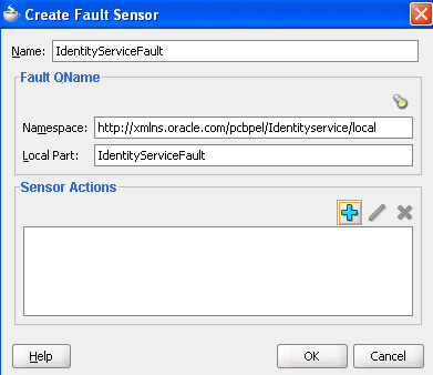

If you want to monitor faults (for this example, from the identity service), you can create a fault sensor.
Right-click Fault, and select Create.
Click the Browse icon above the Namespace field to select to create a fault sensor, as shown in Figure 18-6.
Based on your selection, the Namespace and Local Parts fields are automatically filled in.
A new entry is created in the bpel_process_name_sensor.xml file, as shown in Example 18-3:

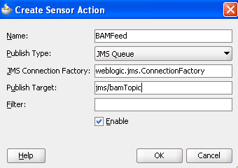

In the Structure window, right-click the Sensor Actions folder.
Select Create > Sensor Action.
Enter the details described in Table 18-1.
Table 18-1 Sensor Actions Dialog
| Field | Description |
Name |
Enter a name or accept the default name. |
Publish Type |
Select the destination to which to publish sensor data. For more information, see section Section 18.1, "Introduction to Sensors." |
JMS Connection Factory |
If your publish type is JMS Queue, JMS Topic, or JMS Adapter, specify the connection factory. |
Publish Target |
If your publish type is JMS Queue, JMS Topic, Custom, or JMS Adapter, specify the publish target. The publish target represents different things depending on the publish type specified:
Filter |
Enter filter logic as a boolean expression. A filter enables you to monitor sensor data within a specific range. For an example of a configured filter, see Figure 18-9 and Example 18-6. |
Enable |
Deselect this checkbox to disable a sensor action. By default, sensor actions are enabled. If you disable a sensor action by deselecting this checkbox, the action does not publish data. |
A new entry is created in the bpel_process_name_sensorAction.xml file, as shown in Example 18-4:
Example 18-4 bpel_process_name_sensorAction.xml file
<action name="BAMFeed"
enabled="true"
publishType="JMSQueue"
publishTarget="jms/bamTopic">
<sensorName>LoanApplicationSensor</sensorName>
<property name=“JMSConnectionFactory“>
weblogic.jms.ConnectionFactory
</property>
</action>

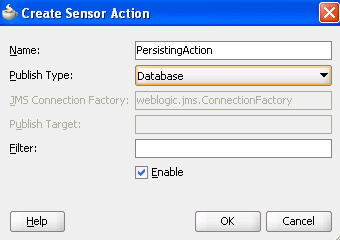

Figure 18-8 Creating an Additional Sensor Action
A new entry is created in the bpel_process_name_sensorAction.xml file, as shown in Example 18-5:
Example 18-5 bpel_process_name_sensorAction.xml file
<action name="PersistingAction"
enabled="true"
publishType="BPELReportsSchema">
<sensorName>CreditRatingSensor</sensorName>
</action

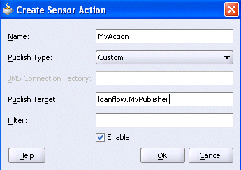

If you have special requirements for a sensor action that cannot be accomplished by using the built-in publish types (database, JMS queue, JMS topic, and JMS Adapter), then you can create a sensor action with the custom publish type, as shown in Figure 18-10. The name in the Publish Target field denotes a fully qualified Java class name that must be implemented. For more information, see Section 18.2.5, "How to Create a Custom Data Publisher."
Figure 18-10 Using the Custom Publish Type

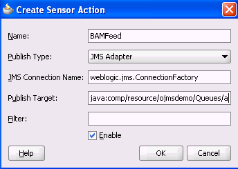

The JMS queue and JMS topic publish types only publish to local JMS destinations. If you want to publish sensor data to remote topics and queues, use the JMS adapter publish type, as shown in Figure 18-11.
Figure 18-11 Using the JMS Adapter Publish Type
In addition to enabling you to publish sensor data to remote topics and queues, the JMS adapter supports a variety of different JMS providers, including:
Third-party JMS providers such as Tibco JMS, IBM WebSphere MQ JMS, and SonicMQ
Oracle Enterprise Messaging Service (OEMS) providers such as memory/file and database
If you select the JMS Adapter publish type, you must create an entry in the weblogic-ra.xml file, which is updated through editing in the Oracle WebLogic Server Administration Console. Each JMS connection factory (pool) entry created in this console corresponds to one JNDI entry in weblogic-ra.xml. Update the Sensor Actions dialog with the chosen JNDI name selected during the creation of the JMS connection factory (pool).
For more information about the JMS adapter, see Oracle Fusion Middleware User's Guide for Technology Adapters.
To create a custom data publisher, perform the following steps:
To create a custom data publisher:
In the Application Navigator, double-click the BPEL project.
The Project Properties dialog appears.
Click Libraries and Classpath.
Browse and select the following:
SOA_ORACLE_HOME\lib\java\shared\oracle.soainfra.common\11.1.1\orabpel.jar
Figure 18-12 provides details.
Create a new Java class.
The package and class name must match the publish target name of the sensor action.
Implement the com.oracle.bpel.sensor.DataPublisher interface.
This updates the source file and fills in the methods and import statements of the DataPublisher interface.
Using the Oracle JDeveloper editor, implement the publish method of the DataPublisher interface, as shown in the sample custom data publisher class in Figure 18-13.
Ensure that the class compiles successfully.
The next time that you deploy the BPEL process, the Java class is added to the SOA archive (SAR) and deployed.
Ensure that additional Java libraries needed to implement the data publisher are in the class path.Oracle BPEL Process Manager can execute multiple process instances simultaneously, so ensure that the code in your data publisher is thread safe, or add appropriate synchronization blocks. To guarantee high throughput, do not use shared data objects that require synchronization.
Oracle JDeveloper automatically updates the composite.xml file to include appropriate properties for sensors and sensor actions, as shown in Example 18-7:
Example 18-7 composite.xml File
<composite name="JMSQFComposite" applicationName="JMSQueueFilterApp"
revision="1.0" label="2007-04-02_14-41-31_553" mode="active" state="on">
<import namespace="http://xmlns.oracle.com/JMSQueueFilter"
location="JMSQueueFilter.wsdl" importType="wsdl"/>
<service name="client">
<interface.wsdl interface="http://xmlns.oracle.com/
JMSQueueFilter#wsdl.interface(JMSQueueFilter)"/>
<binding.ws
port="http://xmlns.oracle.com/JMSQueueFilter#wsdl.endpoint(client/
JMSQueueFilter_pt)"/>
</service>
<component name="JMSQueueFilter">
<implementation.bpel src="JMSQueueFilter.bpel"/>
<property name="configuration.sensorLocation" type="xs:string"
many="false">JMSQueueFilter_sensor.xml</property>
<property name="configuration.sensorActionLocation" type="xs:string"
many="false">JMSQueueFilter_sensorAction.xml</property>
</component>
<wire>
<source.uri>client</source.uri>
<target.uri>JMSQueueFilter/client</target.uri>
</wire>
</composite>
You can specify additional properties with <property name= ...>, as shown in Example 18-7.
