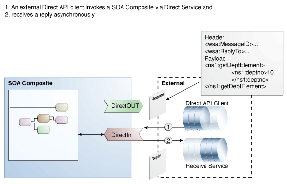

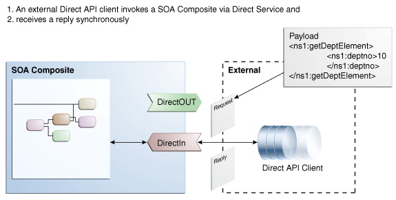

The direct binding components support both synchronous and asynchronous invocation patterns. Figure 37-1 describes a sample synchronous invocation pattern and Figure 37-2 describes a sample asynchronous invocation pattern.
Figure 37-1 Sample Synchronous Invocation Patterns
Figure 37-2 Sample Asynchronous Invocation Pattern

Direct binding also supports the Synchronous Direct Invocation with the usage of the method shown in Example 37-7.
Asynchronous invocation relies on the WS-Addressing headers set on the message instance. All headers must adhere to the WS-Addressing specification.
The Direct Binding Invocation API allows the clients to specify the WS-Addressing ReplyTo SOAP header to communicate a destination by which they can receive responses.
The supported addressing version includes:An example of the WS-Addressing header used for asynchronous invocation is shown in Example 37-8.

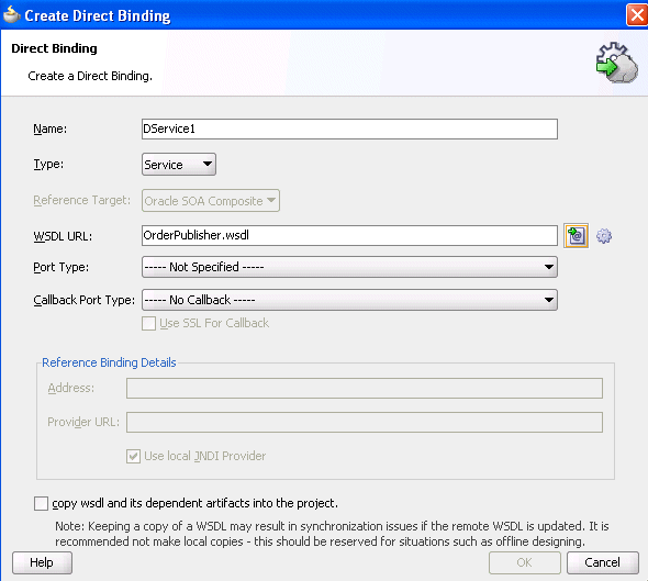

You can invoke a SOA composite application using the Direct Binding option in Oracle JDeveloper.
To create an inbound direct binding service:
Open Oracle JDeveloper.
From the Component Palette, select SOA.
From the Service Adapters list, drag the Direct Binding component into the Exposed Services swimlane. The Create Direct Binding dialog appears.
Enter the details shown in Table 37-1.
Table 37-1 Direct Binding Service Dialog Fields and Values
| Field | Value |
Name |
Enter a name. |
Type |
Select Service from the list. |
Reference Target |
This field is disabled when defining this service in the Exposed Services swimlane. |
WSDL URL |
The URL location of the WSDL file. If you have an existing WSDL, then click the Find Existing WSDLs option. Otherwise, click Generate WSDL from schema(s). |
Port Type |
The port type of the WSDL file. You must select a port from the list. |
Callback Port Type |
The callback port type for asynchronous processes. |
Use SSL For Callback |
Select to use SSL for the callback. |
Address |
This field is automatically populated when the WSDL is concrete and it has at least one binding that is direct. |
Provider URL |
Use local JNDI Provider |
Select to use the local JNDI provider. |
copy wsdl and its dependent artifacts into the project |
Deselect this checkbox. If you select this checkbox, the local copies of the WSDL file may result in synchronization issues if a remote WSDL is updated. |
When complete, the Create Direct Binding dialog appears as shown in Figure 37-4.
Click OK.

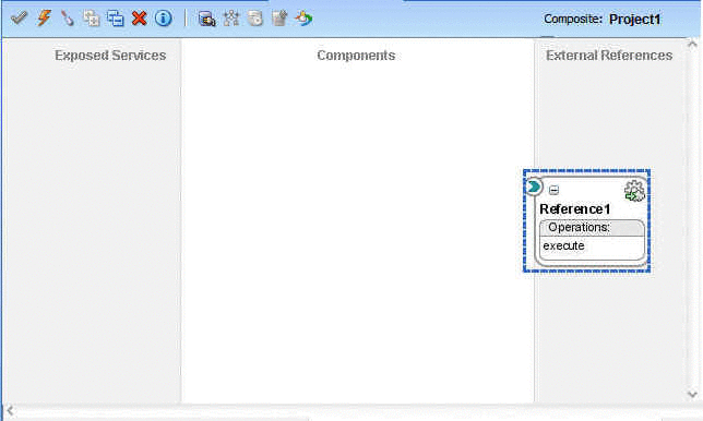

The direct binding service displays in the SOA Composite Editor shown in Figure 37-5. The single arrow in a circle indicates that this is a synchronous, one-way, direct binding component.

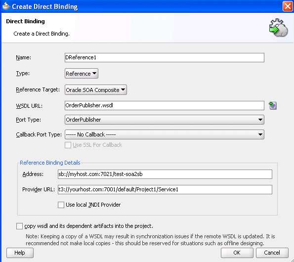

You can create an outbound direct binding reference, using the Direct Binding option in Oracle JDeveloper, to either invoke a composite application or an Oracle Service Bus.
To create an outbound direct binding reference:
From the Service Adapters list, drag the Direct Binding component into the External References swimlane. The Create Direct Binding dialog appears.
Enter the details shown in Table 37-2.
Table 37-2 Direct Binding Service Dialog Fields and Values
| Field | Value |
Name |
Enter a name. |
Type |
Select Reference from the list. |
Reference Target |
Select the reference target on which you want the direct binding service to operate:
WSDL URL |
The URL location of the WSDL file. If you have an existing WSDL, then click the Find Existing WSDLs option. |
Port Type |
Address |
This field is automatically populated when you select a concrete WSDL URL and port type. However, you must manually populate this field if a nonconcrete WSDL is provided. |
Provider URL |
When complete, the Create Direct Binding dialog appears as shown in Figure 37-6. For more information about using the Oracle SOA Suite services with Oracle Service Bus, see the Oracle SOA Suite Transport (SOA-DIRECT) chapter in Oracle Fusion Middleware Developer's Guide for Oracle Service Bus.
Click OK.
The direct binding reference displays in the designer shown in Figure 37-7. The single arrow in a circle indicates that this is a synchronous, one-way direct binding reference component.
