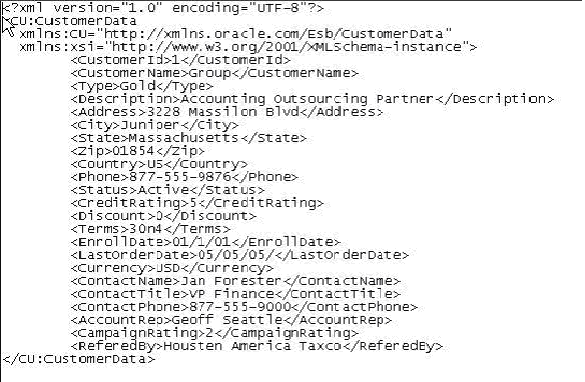

Groups and sequence IDs are identified through XPath expressions in the payload. You specify XPath expressions that point to the elements in the message payload on which grouping is done and on which sequencing is done.
In the message payload shown in Figure 23-1, CustomerId is the field on which to base instance sequencing and CustomerName is the field on which to base grouping.

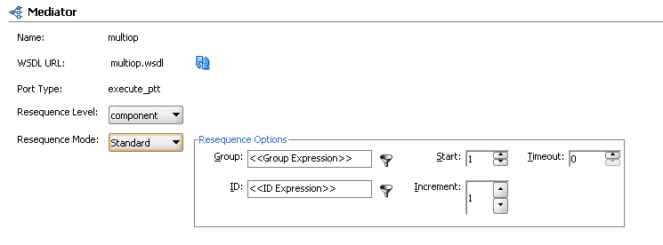

To configure a standard resequencer:
Set the resequence level as described in Section 23.3.1, "How to Specify the Resequencing Level".
On the Mediator Editor under either the Oracle Mediator component or the operation you want to configure, select Standard from the Resequence Mode dropdown list.
The Resequence Options box appears and includes the options for the standard resequencer, as shown in Figure 23-4.
Figure 23-4 Oracle Mediator with Resequence Mode set to Standard
Fill in the fields listed inTable 23-6.
You can either enter the XPath expressions directly in the Group and ID fields or you can click Invoke Expression Builder to the right of each field. This launches the Expression Builder, which provides graphical assistance in creating field expressions and adding functions.Table 23-6 Standard Resequencing Options
| Field Name | Description | Default Value | Mandatory |
| Group | The XPath that points to the field in the incoming message on which grouping is done. If you are editing the MPLAN file directly, the corresponding element is named  | N/A | N |
| ID | The XPath that points to the field in the incoming message on which resequencing is done. If you are editing the MPLAN file directly, the corresponding element is named  | N/A | Y |
| Timeout | The time period in seconds to wait for an expected message. The resequencer locks the group as timed-out if a time out occurs. If you are editing the MPLAN file directly, the corresponding element is named  | N | |
| Start | The starting number of the ID sequence. If you are editing the MPLAN file directly, the corresponding element is named  | 1 | N |
| Increment | The increment of the ID sequence. If you are editing the MPLAN file directly, the corresponding element is named  | 1 | N |
Footnote 1 This default value means that the timeout never happens for a group by default.

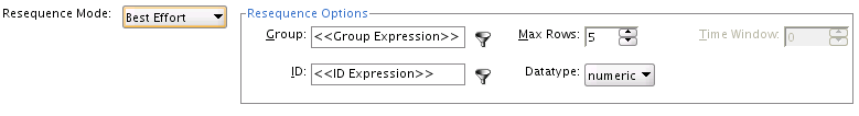

On the Mediator Editor under either the Oracle Mediator component or the operation you want to configure, select Best Effort from the Resequence Mode dropdown list.
The Resequence Options box appears and includes the option for the standard resequencer, as shown in Figure 23-6.
Figure 23-6 Oracle Mediator with Resequence Mode set to Best Effort
Fill in the fields listed in Table 23-7 to configure the best effort resequencer.
Tip:
You can specify either a maximum number of rows to process at one time or a time window for the messages. You cannot specify both.If needed, you can change the percent of the time window that is added as a buffer. You configure the buffer using the Oracle Enterprise Manager Fusion Middleware Control Console.
For instructions, see “Configuring Resequenced Messages” in the Oracle Fusion Middleware Administrator's Guide for Oracle SOA Suite and Oracle BPM Suite.
Table 23-7 Best Effort Resequencing Options
| Group | The XPath that points to the field in the incoming message on which grouping is performed. If you are editing the MPLAN file directly, the corresponding element is named  | N/A | N |
| ID | The XPath that points to the field in the incoming message that contains the ID on which resequencing is performed. If you are editing the MPLAN file directly, the corresponding element is named  | N/A | Y |
| Datatype | The data type of the sequence ID. The ordering process is based on the data type. Supported values are datetime and numeric. If you are editing the MPLAN file directly, the corresponding element is named  | Numeric | Y |
| Time Window | The length of time in minutes to wait after a message arrives to select messages from the data store for resequencing. You must specify a time window or the maximum rows (described below), but not both. If you are editing the MPLAN file directly, the corresponding element is named  | 0 | N |
| Max Rows | Number of in-sequence messages that the resequencer should pick from the data store at a time. If you are editing the MPLAN file directly, the corresponding element is named  | 5 | N |
