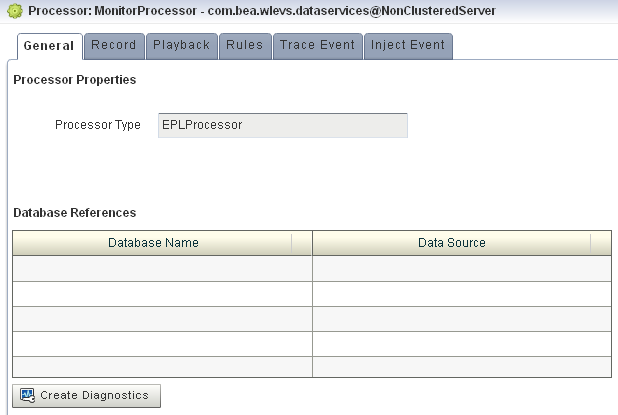

Click the EPL processor in which you want to create an EPL rule.
The Processor panel is displayed as Figure 7-1 shows.

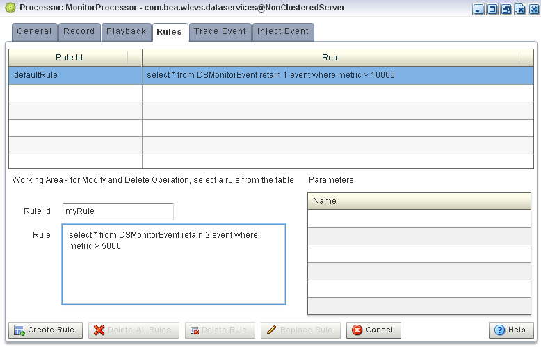

Click in the Rule ID field and enter the name of the rule you want to create.
Click in the Rule field and enter the EPL query string.
Click Create Rule.
A confirmation dialog appears as Figure 7-3 shows.
Click OK.

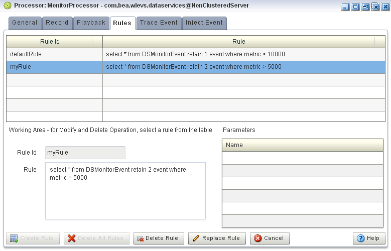

The Rules tab appears as Figure 7-5 shows.
Decide what rules you want to delete:
To delete a single rule:
Select the rule you want to delete.
Click Delete Rule
A confirmation dialog appears as Figure 7-6 shows.
Select the rule you want to replace.
Click in the Rule field and enter the new EPL query string.
Click Replace Rule.
Click OK.

The Rules tab appears as Figure 7-11 shows.
To create a new Rule, enter a the name of the rule in the Rule ID field, enter the EPL query string in the Rule field, then click Create Rule.

To change the default rule, click its name in the Rules table, make the change in the Rule field in the Working Area, and click Replace Rule.
