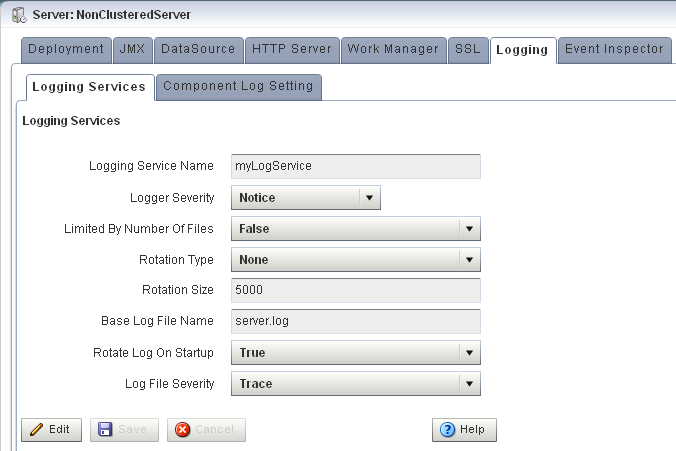

Using the Oracle CEP Visualizer, you can configure the logging system of a selected Oracle CEP server. By default, this logging configuration applies to all components.
To configure component-specific logging options, see Section 19.1.2, "How to Configure a Component Logger".
To configure the Oracle CEP server logging service:
In the left pane, click the Domain > Server node, where Domain refers to the name of your Oracle CEP domain and Server refers to the name of the server instance.
In the right pane, click the Logging tab.
Click the Logging Services tab.
The Logging Services tab appears as Figure 19-1 shows.
Click Edit.
Edit the dialog as Table 19-1 describes.
Table 19-1 Logging Services Options
| Attribute | Description |
Specify the name of the logging service as the Oracle CEP server |
Specify the default log severity at which Oracle CEP server logs messages. |
Specify whether or not to keep old log files indefinitely:
Specify when Oracle CEP server should close the existing log file and open a new one:
When you specify |
The name of the base log file. Default: |
Specify whether or not Oracle CEP server closes the existing log file and creates a new one each time the Oracle CEP server starts up:
Log File Severity |
Specify the default log file severity. Oracle CEP server (and, by default, all components), log messages at this severity:
Click the Save button to commit your changes.

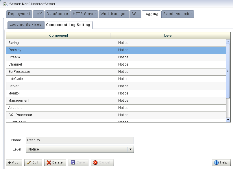

Using the Oracle CEP Visualizer, you can configure the logging properties of a selected component. Table 19-2 lists the components that are configured to log at the Notice log level, by default.
This section describes how:
To configure logging properties that apply to all components, see Section 19.1.1, "How to Configure the Oracle CEP Server Logging Service".
Click the Component Log Setting tab.
The Component Log Setting tab appears as Figure 19-2 show.
Click Add.
Enter the name of the component in the Name field.
You can choose any of the following:
Component name: a component name constant exactly as Table 19-2 lists.
Table 19-2 Logging Component Name Constants
| Component Name | Description |
Applies to log messages from adapter instances running on the Oracle CEP server. |
Applies to log messages from caching systems and cache instances running on the Oracle CEP server. |
Applies to log messages from channels running on the Oracle CEP server. |
Applies to log messages from Oracle CQL processors running on the Oracle CEP server. |
Applies to log messages from EPL processors running on the Oracle CEP server. |
Applies to log messages from the Event-Driven Environment, the Oracle CEP server event-dispatching infrastructure. |
When set to At the
<May 26, 2009 5:53:49 PM PDT> <Info> <EventTrace> <BEA-000000>
<Application [helloworld], Stage [helloworldOutputChannel]
received insert event>
At the
<May 26, 2009 6:02:34 PM PDT> <Debug> <EventTrace> <BEA-000000>
received insert event [HelloWorldEvent: HelloWorld - the
current time is: 6:02:34 PM]>
Applies to log messages from Oracle CEP server and application lifecycle operations. |
Applies to log messages from Oracle CEP server general JMX-related management API operations. |
Applies to log messages from the Oracle CEP server monitoring service. |
Applies to log messages from Oracle CEP server event recording and playback operations. |
Applies to log messages from Spring container operations. |
Applies to log messages from stream instances running on the Oracle CEP server. |
Application name: the module name of any Oracle CEP server or user-defined application. For example: sample.HelloWorld.
Package name: the name of any Oracle CEP server or user-supplied Java package. For example: com.bea.wlevs.ede.
For more information on Oracle CEP server packages, see the Oracle Fusion Middleware Java API Reference for Oracle Complex Event Processing.
Class name: the fully qualified name of any Oracle CEP server or user-defined class. For example: com.bea.wlevs.cep.core.EPRuntimeImpl.
For more information on Oracle CEP server classes, see the Oracle Fusion Middleware Java API Reference for Oracle Complex Event Processing.
Select the severity level from the Level drop-down menu:
Emergency
Alert
Critical
Error
Warning
Notice
Info
Debug
Trace
Click Save.
The component and the severity level is displayed in the table.
To change the logging level of a component:
The Component Log Setting tab appears as Figure 19-3 show.
Select the component entry in the table.
Click Edit.
Emergency
Alert
Critical
Error
Warning
Notice
Info
Debug
Trace
Click Save.
The new severity level is displayed in the table.

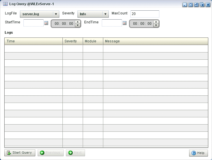

This section describes:
Using the Oracle CEP Visualizer, you can run queries on the logs of a selected Oracle CEP server. The Query Logs feature allows you to view the information in the selected log files.
Click Services and then click Log Query.
The Log Query screen is displayed, as shown in Figure 19-6.
Select the following options in the Log Query screen:
LogFile: Select the log file you want to query from the drop-down.
Severity: Select the severity of the log file that you selected in the LogFile drop-down.
MaxCount: Enter the maximum count of rows of log you wish to view for the selected log file.
StartTime: Select the time when the query should start running.
EndTime: Select the time when the query should stop.
Click Start Query.
All the log messages that match your query criteria for the selected log file of the selected Oracle CEP Server are displayed in the Logs pane, as shown in Figure 19-7.
Figure 19-7 Log Query Screen - Logs Displayed
If more messages are returned than can be displayed in the Logs pane, the Previous and Next buttons activate. Click the Previous and Next buttons to page through the messages.
