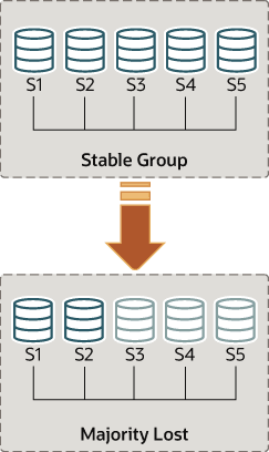

Figure 20.14 Losing Quorum
Five server instances, S1, S2, S3, S4, and S5, are deployed as an interconnected group, which is a stable group. When three of the servers, S3, S4, and S5, fail, the majority is lost and the group can no longer proceed without intervention.
To understand this type of network partition the following section describes a scenario where there are initially 5 servers working together correctly, and the changes that then happen to the group once only 2 servers are online. The scenario is depicted in the figure.

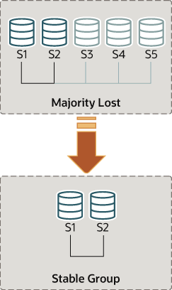

Figure 20.15 Forcing a New Membership
Three of the servers in a group, S3, S4, and S5, have failed, so the majority is lost and the group can no longer proceed without intervention. With the intervention described in the following text, S1 and S2 are able to form a stable group by themselves.
Suppose that you are back in the situation where s1 and s2 are the only servers left in the group. Servers s3, s4 and s5 have left the group unexpectedly. To make servers s1 and s2 continue, you want to force a membership configuration that contains only s1 and s2.
