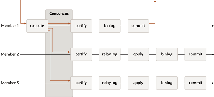

The following figure depicts the MySQL Group Replication protocol and by comparing it to MySQL Replication (or even MySQL semisynchronous replication) you can see some differences. Some underlying consensus and Paxos related messages are missing from this picture for the sake of clarity.
Figure 20.3 MySQL Group Replication Protocol
A transaction received by Source 1 is executed. Source 1 then sends a message to the replication group, consisting of itself, Source 2, and Source 3. When all three members have reached consensus, they certify the transaction. Source 1 then writes the transaction to its binary log, commits it, and sends a response to the client application. Sources 2 and 3 write the transaction to their relay logs, then apply it, write it to the binary log, and commit it.
