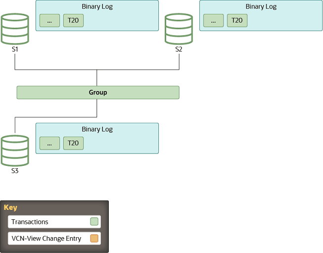

Figure 20.8 Stable Group
Servers S1, S2, and S3 are members of the group. The most recent item in all of their binary logs is transaction T20.

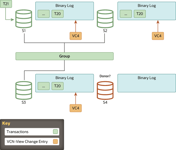

Figure 20.9 A Member Joins
Server S4 joins the group and looks for a donor. Servers S1, S2, and S3 each queue the view change entry VC4 for their binary logs. Meanwhile, server S1 is receiving new transaction T21.

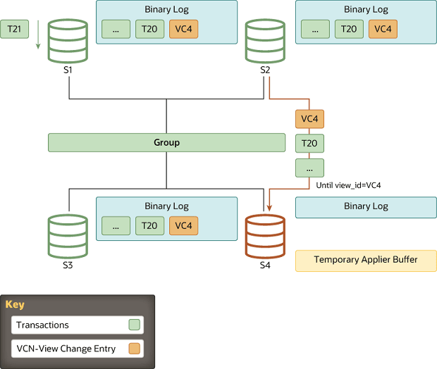

Figure 20.10 State Transfer: Catching Up
Server S4 has chosen server S2 as the donor. State transfer is executed from server S2 to server S4 until the view change entry VC4 is reached (view_id = VC4). Server S4 uses a temporary applier buffer for state transfer, and its binary log is currently empty.

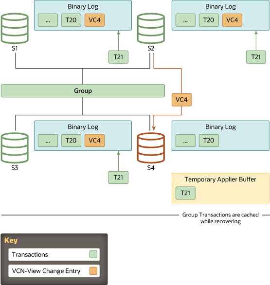

Figure 20.11 Queued Transactions
State transfer is complete. Server S4 has applied the transactions up to T20 and written them to its binary log. Server S4 has cached transaction T21, which arrived after the view change, in a temporary applier buffer while recovering.

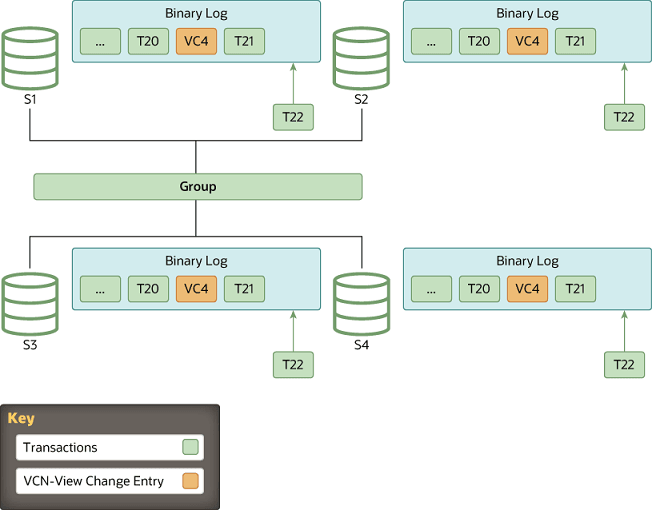

Figure 20.12 Instance Online
Server S4 is now an online member of the group. It has applied cached transaction T21, so its binary log shows the same items as the binary logs of the other group members, and it no longer needs the temporary applier buffer. New incoming transaction T22 is now received and applied by all group members.
