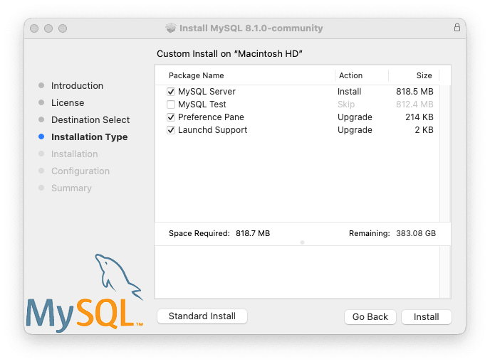

  3. From the Installation Type page you can either click Install to execute the installation wizard using all defaults, click Customize to alter which components to install (MySQL server, MySQL Test, Preference Pane, Launchd Support -- all but MySQL Test are enabled by default).

    Figure 2.5 MySQL Package Installer Wizard: Customize
    Customize shows three package name options: MySQL Server, MySQL Test, Preference Pane, and Launchd Support. All three options are checked.
