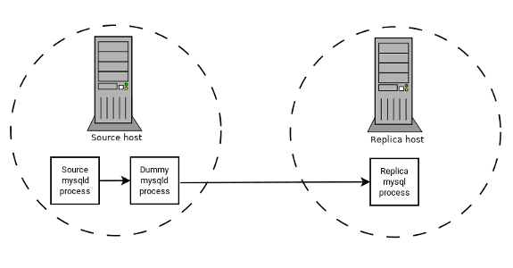

    Suppose that your application requires replica-side filtering rules,
    but transferring all binary log data to the replica first results in
    too much traffic. In such a case, it is possible to set up on the
    replication source server a “dummy” replica process
    whose default storage engine is BLACKHOLE,
    depicted as follows:
    The source writes to its binary log. The “dummy”
    mysqld process acts as a replica, applying the
    desired combination of replicate-do-* and
    replicate-ignore-* rules, and writes a new,
    filtered binary log of its own. (See
    Section 19.1.6, “Replication and Binary Logging Options and Variables”.) This filtered log is
    provided to the replica.
The dummy process does not actually store any data, so there is little processing overhead incurred by running the additional mysqld process on the replication source server. This type of setup can be repeated with additional replicas.
