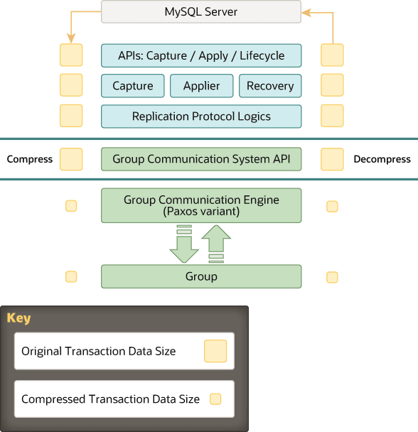

Compression for messages sent in the group happens at the group communication engine level, before the data is handed over to the group communication thread, so it takes place within the context of the mysql user session thread. If the message payload size exceeds the threshold set by group_replication_compression_threshold, the transaction payload is compressed before being sent out to the group, and decompressed when it is received. Upon receiving a message, the member checks the message envelope to verify whether it is compressed or not. If needed, then the member decompresses the transaction, before delivering it to the upper layer. This process is shown in the following figure.
Figure 20.13 Compression Support
The MySQL Group Replication plugin architecture is shown as described in an earlier topic, with the five layers of the plugin positioned between the MySQL server and the replication group. Compression and decompression are handled by the Group Communication System API, which is the fourth layer of the Group Replication plugin. The group communication engine (the fifth layer of the plugin) and the group members use the compressed transactions with the smaller data size. The MySQL Server core and the three higher layers of the Group Replication plugin (the APIs, the capture, applier, and recovery components, and the replication protocol module) use the original transactions with the larger data size.
