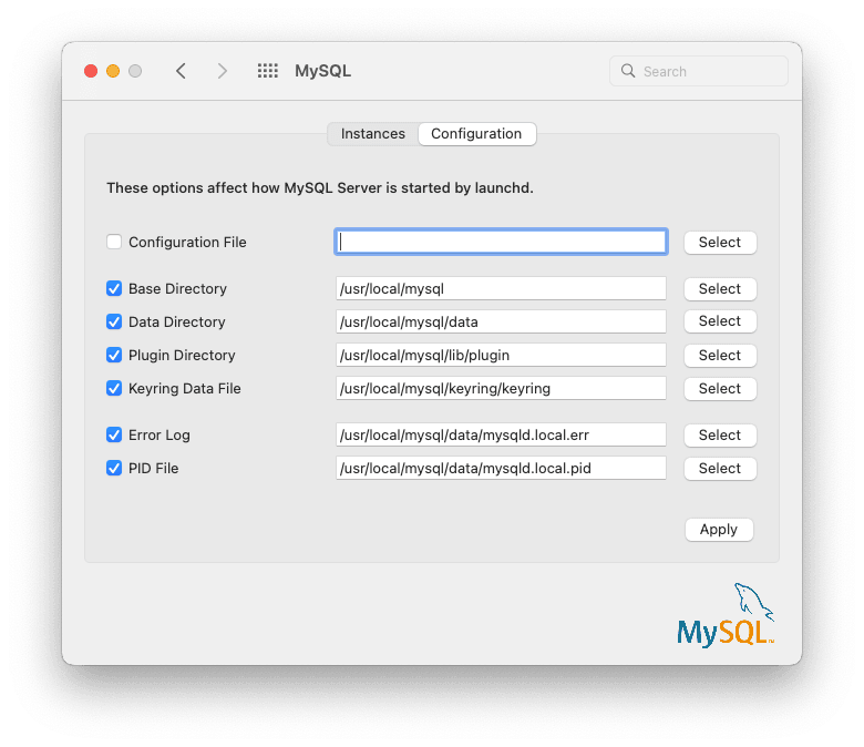

The Configuration page shows MySQL Server options including the path to the MySQL configuration file.
Figure 2.11 MySQL Preference Pane: Configuration
Content is described in the surrounding text.
