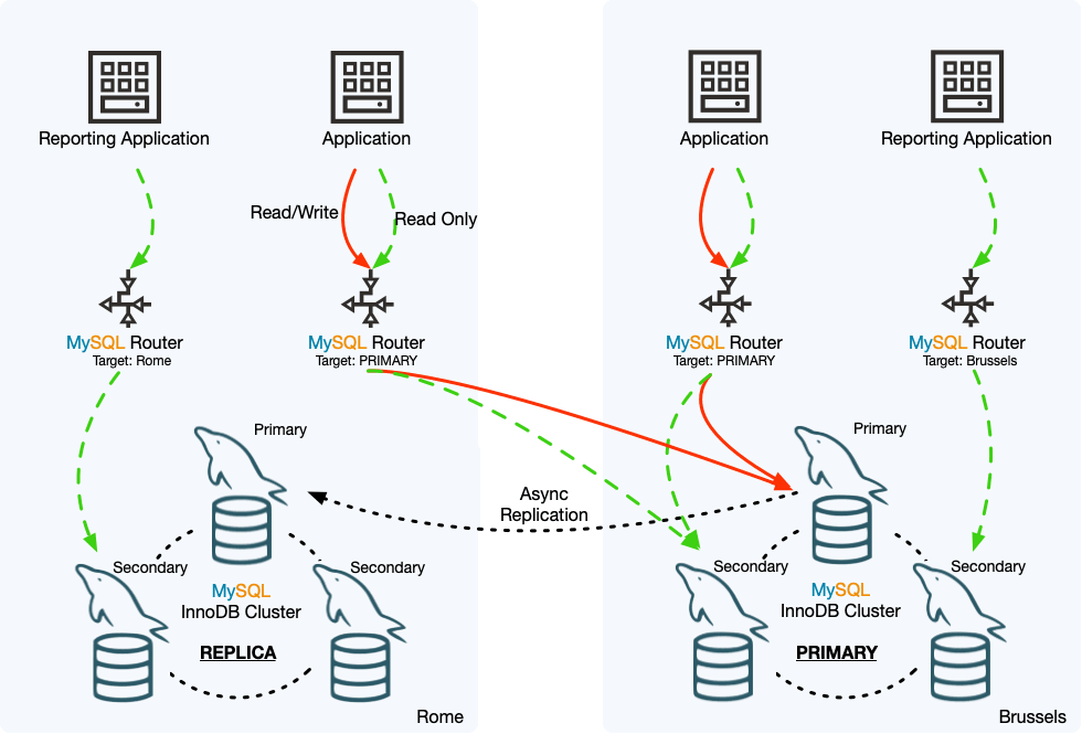

If you cannot fix the issue by working with the primary cluster (for example, because you cannot contact it), you need to perform an emergency failover. An emergency failover is designed for disaster recovery when the primary cluster is suddenly unavailable. That procedure carries the risk of losing transactions and creating a split-brain situation for the InnoDB ClusterSet. If you do need to carry out an emergency failover, follow the procedure in Section 8.9, “InnoDB ClusterSet Emergency Failover” to ensure that the risk is managed.
The diagram shows the effects of a controlled switchover in an example InnoDB ClusterSet deployment. The primary cluster in the Rome datacenter requires maintenance, so a controlled switchover has been carried out to make the replica cluster in the Brussels datacenter into the primary of the InnoDB ClusterSet deployment, and demote the Rome cluster to a replica. The ClusterSet replication channel on the Rome cluster has been activated by the controlled switchover process, and it is replicating transactions from the Brussels cluster. Now that the Rome cluster is a replica cluster, the member servers or the complete cluster can safely be taken offline if required to carry out the maintenance work.
The MySQL Router instances in the example InnoDB Cluster deployment that were set to follow the primary have routed read and write traffic to the Brussels cluster which is now the primary. The MySQL Router instance that was routing read traffic to the Brussels cluster by name when it was a replica cluster, continues to route traffic to it, and is not affected by the fact that the cluster is now the primary rather than a replica cluster. Similarly, the MySQL Router instance that was routing read traffic to the Rome cluster by name can continue to do this, because the replica cluster still accepts read traffic.
To carry out a controlled switchover for the primary InnoDB Cluster, follow this procedure:

By default, a MySQL Router instance sends traffic to whichever
cluster is currently the primary in the InnoDB ClusterSet
deployment. If all the MySQL Router instances are set to follow
the primary ("target_cluster": "primary"),
traffic will be automatically redirected to the new primary
cluster within a few seconds of the switchover. If a routing
option is not displayed for a MySQL Router instance, as in the
example above for Rome2, it means the
instance does not have that policy set, and it follows the
global policy.
