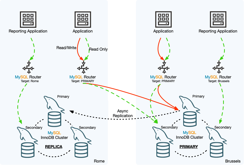

The diagram shows the effects of a controlled switchover in an example InnoDB ClusterSet deployment. The primary cluster in the Rome datacenter requires maintenance, so a controlled switchover has been carried out to make the replica cluster in the Brussels datacenter into the primary of the InnoDB ClusterSet deployment, and demote the Rome cluster to a replica. The ClusterSet replication channel on the Rome cluster has been activated by the controlled switchover process, and it is replicating transactions from the Brussels cluster. Now that the Rome cluster is a replica cluster, the member servers or the complete cluster can safely be taken offline if required to carry out the maintenance work.
Figure 9.2 InnoDB ClusterSet Switchover
The InnoDB Cluster in the Rome datacenter is now a replica cluster, and the InnoDB Cluster in the Brussels datacenter is now the primary cluster. The asynchronous replication channel is now sending transactions from the Brussels cluster to the Rome cluster. The MySQL Router instances that targeted the primary or the Brussels cluster are sending traffic to the Brussels cluster. The instance that specifically targeted the Rome cluster can continue to send traffic to it because it is only sending read traffic.
The MySQL Router instances in the example InnoDB Cluster deployment that were set to follow the primary have routed read and write traffic to the Brussels cluster which is now the primary. The MySQL Router instance that was routing read traffic to the Brussels cluster by name when it was a replica cluster, continues to route traffic to it, and is not affected by the fact that the cluster is now the primary rather than a replica cluster. Similarly, the MySQL Router instance that was routing read traffic to the Rome cluster by name can continue to do this, because the replica cluster still accepts read traffic.
