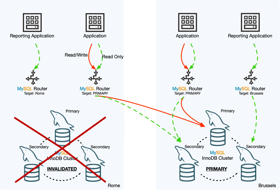

The diagram shows the effects of an emergency failover in an example InnoDB ClusterSet deployment. The primary cluster in the Rome datacenter has gone offline, so an emergency failover has been carried out to make the replica cluster in the Brussels datacenter into the primary InnoDB Cluster of the InnoDB ClusterSet deployment. The Rome cluster has been marked as invalidated, and its status in the InnoDB ClusterSet deployment has been demoted to a replica cluster, although it is not currently able to replicate transactions from the Brussels cluster.
Figure 9.3 InnoDB ClusterSet Failover
The InnoDB Cluster in the Rome datacenter is now offline and invalidated, and the InnoDB Cluster in the Brussels datacenter is now the primary cluster. Asynchronous replication between the two is not taking place because the Rome cluster is not available. The MySQL Router instances that targeted the primary or the Brussels cluster are sending traffic to the Brussels cluster. The instance that specifically targeted the Rome cluster cannot send traffic to the cluster.
The MySQL Router instances that were set to follow the primary have routed read and write traffic to the Brussels cluster which is now the primary. The MySQL Router instance that was routing read traffic to the Brussels cluster by name when it was a replica cluster, continues to route traffic to it, and is not affected by the fact that the cluster is now the primary rather than a replica cluster. However, the MySQL Router instance that was routing read traffic to the Rome cluster by name cannot currently send any traffic there. The reporting application in this example does not need to report when the local datacenter is offline, but if the application did still need to function, the MySQL Router instance should have its routing options changed either to follow the primary or to send traffic to the Brussels cluster.
