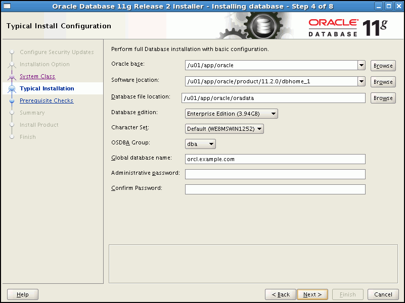

The Typical Install Configuration window appears.
Provide the following configuration details for the database:
Oracle Base Location— The Oracle base directory helps to facilitate the organization of multiple Oracle software installations. See the Oracle Database Installation Guide for your platform for more information about ORACLE_BASE.
If you did not set the ORACLE_BASE environment variable before starting OUI, then the Oracle base directory is created in an app/username/directory on the first existing and writable directory from /u01 through /u09 for UNIX and Linux systems, or on the disk drive with the most available space for Windows systems. If /u01 through /u09 does not exist on the UNIX or Linux system, then the default location is user_home_directory/app/username.
You can click Browse to find the directory you want to act as the Oracle base directory.
Software Location—The software location is the Oracle home for your database. You must specify a new Oracle home directory for each new installation of Oracle Database software. By default, the Oracle home directory is a subdirectory of the Oracle base directory.
You can click Browse to find the directory where you want to install the Oracle Database software.
Database File Location—The database file location is the location where Oracle Database files are stored. By default, this location is Oracle_base/oradata. You can click Browse to select a different location.
Database Edition—Select either Enterprise Edition, Standard Edition, Standard Edition One, or Personal Edition (Microsoft Windows platforms only). See "Installation Type".
Character Set—Choose the character set to use to store the data within the database. You can choose between the Default, which is based on the operating system language settings, or Unicode.
OSDBA Group (Linux and UNIX platforms only)—Specify the operating system DBA group. Host computer users in this group have administrative privileges on the database. This group is typically named dba. Refer to Oracle Database Installation Guide for Linux or for your UNIX platform for more details.
Global Database Name—Enter the fully qualified global database name. See "Installation Type" for more on global database name.
Administrative Password—Specify the initial password for the SYS, SYSTEM, SYSMAN, and DBSNMP administrator accounts. If the password you choose is not a secure password, a warning message will be displayed.
After you enter the required information, click Next.
