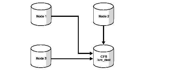

The preferred configuration for Oracle RAC is to use Oracle Automatic Storage Management (Oracle ASM) for a recovery area with a different disk group for your recovery set than for your data files. Alternatively, you can use a cluster file system archiving scheme.
If you use a cluster file system, then each node writes to a single location on the cluster file system when archiving the redo log files. Each node can read the archived redo log files of the other nodes. For example, as shown in Figure 6-1, if Node 1 archives a redo log file to /arc_dest/log_1_100_23452345.arc on the cluster file system, then any other node in the cluster can also read this file.
Figure 6-1 Cluster File System Archiving Scheme
The archive log naming format in this example is only for a cluster file system example. Oracle ASM uses an Oracle Managed Files (OMF)-based naming format.If you do not use a cluster file system, then the archived redo log files cannot be on raw devices. This is because raw devices do not enable sequential writing of consecutive archive log files.
The advantage of this scheme is that none of the nodes uses the network to archive logs. Because the filename written by a node can be read by any node in the cluster, RMAN can back up all logs from any node in the cluster. Backup and restore scripts are simplified because each node has access to all archived redo logs.
In the cluster file system scheme, each node archives to a directory that is identified with the same name on all instances within the cluster database. To configure this directory, set values for the LOG_ARCH_DEST_n parameter for each instance using the sid designator as in the following example:
sid1.LOG_ARCHIVE_DEST_1="LOCATION=/arc_dest" sid2.LOG_ARCHIVE_DEST_1="LOCATION=/arc_dest" sid3.LOG_ARCHIVE_DEST_1="LOCATION=/arc_dest"
The following list shows archived redo log entry examples that would appear in the RMAN catalog or the in the control file based on the previous example. Note that any node can archive logs using any of the threads:
/arc_dest/log_1_999_23452345.arc /arc_dest/log_1_1000_23435343.arc /arc_dest/log_1_1001_23452345.arc <- thread 1 archived in node 3 /arc_dest/log_3_1563_23452345.arc <- thread 3 archived in node 2 /arc_dest/log_2_753_23452345.arc <- thread 2 archived in node 1 /arc_dest/log_2_754_23452345.arc /arc_dest/log_3_1564_23452345.arc
