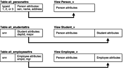

This section describes three possible storage models. In the first, a flat model, all views in the object view hierarchy are based on the same table. In the second, a horizontal model, each view has a one-to-one correspondence with a different table. And in the third, a vertical model, the views are constructed using joins.
To execute any of these storage models, first create types shown in Example 6-16.
Example 6-16 Creating Types for Storage Model Examples
CREATE TYPE person_typ AS OBJECT ( ssn NUMBER, name VARCHAR2(30), address VARCHAR2(100)) NOT FINAL;/ CREATE TYPE student_typ UNDER person_typ ( deptid NUMBER, major VARCHAR2(30)) NOT FINAL;/ CREATE TYPE employee_typ UNDER person_typ ( empid NUMBER, mgr VARCHAR2(30));/
In the flat model, all the views in the hierarchy are based on the same table. In the following example, the single table AllPersons contains columns for all the attributes of person_typ, student_typ, and employee_typ.
Figure 6-2 Flat Storage Model for Object View Hierarchy
The typeid column identifies the type of each row. These possible values are the types created in Example 6-16, 1 = person_typ, 2 = student_typ, and 3 = employee_typ:
Example 6-17 creates the table AllPersons and then the views that make up the object view hierarchy:
Example 6-17 Creating an Object View Hierarchy
-- Requires Ex. 6-16 CREATE TABLE AllPersons ( typeid NUMBER(1), ssn NUMBER, name VARCHAR2(30), address VARCHAR2(100), deptid NUMBER, major VARCHAR2(30), empid NUMBER, mgr VARCHAR2(30)); CREATE VIEW Person_v OF person_typ WITH OBJECT OID(ssn) AS SELECT ssn, name, address FROM AllPersons WHERE typeid = 1; CREATE VIEW Student_v OF student_typ UNDER Person_v AS SELECT ssn, name, address, deptid, major FROM AllPersons WHERE typeid = 2; CREATE VIEW Employee_v OF employee_typ UNDER Person_v AS SELECT ssn, name, address, empid, mgr FROM AllPersons WHERE typeid = 3;
The flat model has the advantage of simplicity and poses no obstacles to supporting indexes and constraints. Its drawbacks are:
A single table cannot contain more than 1000 columns, so the flat model imposes a 1000-column limit on the total number of columns that the object view hierarchy can contain.
Each row of the table will have NULLs for all the attributes not belonging to its type. Such non-trailing NULLs can adversely affect performance.
On the horizontal model, each view or subview is based on a different table. In the example, the tables are relational, but they could just as well be object tables for which column substitutability is turned off.
Figure 6-3 Horizontal Storage Model for Object View Hierarchy
Example 6-18 creates tables and then views based on these tables.
Example 6-18 -- Creating Table Horizontal Model
-- Requires Ex. 6-16 and Ex. 6-17 CREATE TABLE only_persons ( ssn NUMBER, name VARCHAR2(30), address VARCHAR2(100)); CREATE TABLE only_students ( ssn NUMBER, name VARCHAR2(30), address VARCHAR2(100), deptid NUMBER, major VARCHAR2(30)); CREATE TABLE only_employees ( ssn NUMBER, name VARCHAR2(30), address VARCHAR2(100), empid NUMBER, mgr VARCHAR2(30)); CREATE OR REPLACE VIEW Person_v OF person_typ WITH OBJECT OID(ssn) AS SELECT * FROM only_persons; CREATE OR REPLACE VIEW Student_v OF student_typ UNDER Person_v AS SELECT * FROM only_students; CREATE OR REPlACE VIEW Employee_v OF employee_typ UNDER Person_v AS SELECT * FROM only_employees;
The horizontal model is very efficient at processing queries of the form:
Example 6-19 -- Querying views horizontal model
-- Requires Ex. 6-16 and Ex. 6-17 -- add the following data insert into only_persons values(1234,'John','abc'); insert into only_students values(1111,'James','abc',100,'CS'); insert into only_employees values(2222,'jack','abc',400,'Juliet'); SELECT VALUE(p) FROM Person_v p WHERE VALUE(p) IS OF (ONLY student_typ); OUTPUT: VALUE(P)(SSN, NAME, ADDRESS) -------------------------------------------------------------------------------- STUDENT_TYP(1111, 'James', 'abc', 100, 'CS')
Such queries only need to access a single physical table to get all the objects of the specific type. The drawbacks of this model are that queries such as SELECT * FROM view require performing a UNION over all the underlying tables and projecting the rows over just the columns in the specified view. (See "Querying a View in a Hierarchy".) Also, indexes on attributes (and unique constraints) must span multiple tables, and support for this does not currently exist.
In the vertical model, there is a physical table corresponding to each view in the hierarchy, but the physical tables store only those attributes that are unique to their corresponding subtypes.
Figure 6-4 Vertical Storage Model for Object View Hierarchy
Example 6-20 creates tables and then corresponding views.
