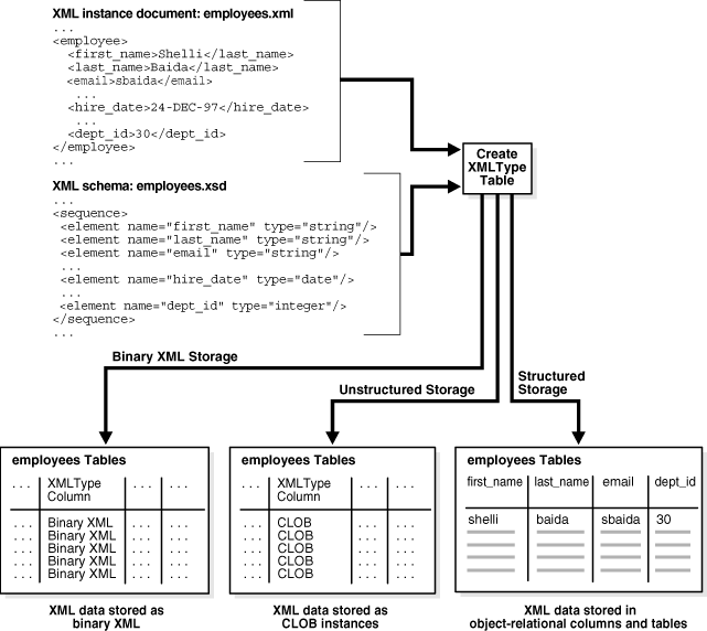

Before an XML schema can be used by Oracle XML DB, it must be registered with Oracle Database. You register an XML schema using the PL/SQL package DBMS_XMLSCHEMA.
Some of the main DBMS_XMLSCHEMA procedures are these:
registerSchema – Register an XML schema with Oracle Database
deleteSchema – Delete a previously registered XML schema.
copyEvolve – Update a registered XML schema. See Chapter 10, "XML Schema Evolution".
The main parameters to procedure DBMS_XMLSCHEMA.registerSchema are these:
SCHEMAURL – the XML schema URL. This is a unique identifier for the XML schema within Oracle XML DB. It is conventionally in the form of a URL, but this is not a requirement. The XML schema URL is used with Oracle XML DB to identify instance documents, by making the schema location hint identical to the XML schema URL. Oracle XML DB never tries to access a Web server identified by the specified URL.
You cannot register an XML schema using the sameSCHEMAURL as any system-defined XML schema.SCHEMADOC – The XML schema source document. This is a VARCHAR, CLOB, BLOB, BFILE, XMLType, or URIType value.
CSID – The character-set ID of the source-document encoding, when schemaDoc is a BFILE or BLOB value.
OPTIONS – Options that specify how the XML schema should be registered. The most important option is REGISTER_BINARYXML, which indicates that the XML schema is used for binary XML storage. Another option is REGISTER_NT_AS_IOT, which forces OCTs to be stored as index-organized tables (IOTs).
If you specify optionREGISTER_BINARYXML, then you must also set parameter GENTYPES to FALSE.The code in Example 7-3 registers the XML schema at URL http://xmlns.oracle.com/xdb/documentation/purchaseOrder.xsd. This example shows how to register an XML schema using the BFILE mechanism to read the source document from a file on the local file system of the database server.
When you register an XML schema, keep in mind that the act of registering a schema has no effect on the status of any instance documents already loaded into Oracle XML DB Repository that reference the XML schema. Because the XML schema was not yet registered, such instance documents were non-schema-based when they were loaded. They remain non-schema-based after the schema is registered.
You must delete such instance documents, and reload them after registering the schema, in order to obtain schema-based documents.
As part of registering an XML schema, Oracle XML DB also performs several tasks that facilitate storing, accessing, and manipulating XML instances that conform to the XML schema. These steps include:
Mapping XML Schema data types to Oracle XML DB storage. When XML schema-based data is stored, its storage data types are derived from the XML Schema data types using a default mapping and, optionally, using mapping information that you specify using XML schema annotations. For binary XML storage, XML Schema types are mapped to binary XML encoding types. For object-relational storage, XML schema registration creates the appropriate SQL object types for the structured storage of conforming documents.
Creating default tables. XML schema registration generates default XMLType tables for all global elements. You can use XML-schema annotations to control the names of the tables, and to provide column-level and table-level storage clauses and constraints for use during table creation.
After XML schema registration, documents that reference the XML schema using the XML Schema instance mechanism can be processed automatically by Oracle XML DB. For XML data that is stored object-relationally, XMLType tables and columns can be created that are constrained to the global elements defined by the XML schema.

Using Oracle XML DB, you can create XMLType tables and columns that are constrained to a global element defined by a registered XML schema. After an XMLType column has been constrained to a particular element and a particular XML schema, it can only contain documents that are compliant with the schema definition of that element. You constrain an XMLType table column to a particular element and XML schema by adding appropriate XMLSCHEMA and ELEMENT clauses to the CREATE TABLE operation.
Figure 7-1 through Figure 7-4 show the syntax for creating an XMLType table.
See Also:
Oracle Database SQL Language Reference for the complete description ofCREATE TABLE, including syntax elements such as object_properties.Note:
To create anXMLType table in a different database schema from your own, you must have not only privilege CREATE ANY TABLE but also privilege CREATE ANY INDEX. This is because a unique index is created on column OBJECT_ID when you create the table. Column OBJECT_ID stores a system-generated object identifier.Figure 7-1 Creating an XMLType Table – CREATE TABLE
Figure 7-2 Creating an XMLType Table – XMLType_table
Figure 7-3 Creating an XMLType Table – table_properties
Figure 7-4 Creating an XMLType Table – XMLType_virtual_columns
For XML data, virtual columns are used primarily for partitioning or defining SQL constraints. If your need is to project out specific XML data in order to access it relationally, then consider using SQL/XML functionXMLTable or XMLIndex with a structured component. See also:
A subset of the XPointer notation can also be used to provide a single URL that contains the XML schema location and element name. See also Chapter 4, "XMLType Operations".
Example 7-20 shows two CREATE TABLE statements. The first creates XMLType table purchaseorder_as_table. The second creates relational table purchaseorder_as_column, which has XMLType column xml_document. In each table, the XMLType instance is constrained to the PurchaseOrder element that is defined by the XML schema registered with URL http://xmlns.oracle.com/xdb/documentation/purchaseOrder.xsd.
Example 7-20 Creating XML Schema-Based XMLType Tables and Columns
CREATE TABLE purchaseorder_as_table OF XMLType XMLSCHEMA "http://xmlns.oracle.com/xdb/documentation/purchaseOrder.xsd" ELEMENT "PurchaseOrder"; CREATE TABLE purchaseorder_as_column (id NUMBER, xml_document XMLType) XMLTYPE COLUMN xml_document ELEMENT "http://xmlns.oracle.com/xdb/documentation/purchaseOrder.xsd#PurchaseOrder";
There are two ways to specify XMLSchema and Element:
as separate clauses, XMLSchema and Element
using only the Element clause with an XPointer notation
The data associated with an XMLType table or column that is constrained to an XML schema can be stored in different ways:
Decomposed and stored object-relationally (structured storage)
Stored as text, using a single CLOB column (unstructured storage)
Stored as binary XML, using a single binary-XML column (binary XML storage)

Figure 7-5 shows how Oracle XML DB creates XML schema-based XMLType tables using an XML document and a mapping specified in an XML schema. Depending on the storage method specified in the XML schema, an XML instance document is stored either as a binary XML or CLOB value in a single XMLType column, or using multiple object-relational columns.
Figure 7-5 How Oracle XML DB Maps XML Schema-Based XMLType Tables
