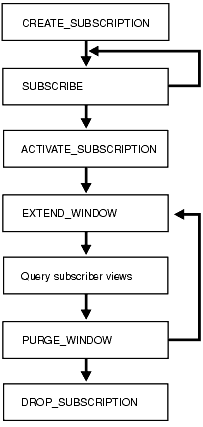

Figure 34-1 provides a graphical flowchart of the order in which subscribers most typically use the subprograms in the DBMS_CDC_SUBSCRIBE package (which are listed in Table 34-1). A subscriber would typically create a subscription, subscribe to one or more source tables and columns, activate the subscription, extend the subscription window, query the subscriber views, purge the subscription window, and then either extend the subscription window again or drop the subscription.
If a subscriber uses thePURGE_WINDOW procedure immediately after using an EXTEND_WINDOW procedure, then change data may be lost without ever being processed.See Also:

All specified source tables or publications must be in the change set that is associated with the named subscription.
A single source table can have more than one publication defined on it. A subscriber can subscribe to one or more of these publications. However a subscriber can subscribe to a particular publication only once.
Each publication in a subscription has its own subscriber view. Subscriber views are used to query the change data encompassed by the subscription's current window. Subscriber views are created in the schema of the subscriber.
A subscriber cannot subscribe to a publication within a change set that has reached its end_date parameter value.
