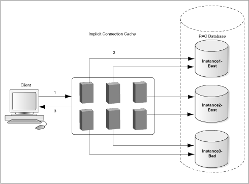

In an Oracle Real Application Clusters environment, a connection could belong to any instance that provides the relevant service. In the best case, all instances perform equally well and randomly retrieving a connection from the cache is appropriate. However, when one instance performs better than others, random selection of a connection is inefficient. The run-time connection load balancing feature enables routing of work requests to an instance that offers the best performance, minimizing the need to relocate work.
Figure 22-1 illustrates run-time connection load balancing. When run-time connection load balancing is enabled on the implicit connection cache, the following steps occur:
A client requests a connection from the connection cache by calling the getConnection method on the DataSource object.
The run-time connection load balancing mechanism selects the connection that belongs to the best instance from the connection cache. In Figure 22-1, this could be either Instance1 or Instance2.
The client receives the connection that would process the work request with the best response time.
Figure 22-1 Run-Time Connection Load Balancing
Connection retrieval based on the load balancing advisory is automatic. A request for a connection is serviced by selecting a connection based on the service goal as determined by the Load Balancing Advisory. The service goal determines whether the connection provides best service quality, that is, how efficiently a single transaction completes, or best throughput, that is, how efficiently an entire job or long-running query completes. The advisory is used by the connection cache as long as the events are posted by Oracle Real Application Clusters. When the events stop arriving, the connection cache reverts to random retrieval of connections from the cache.
