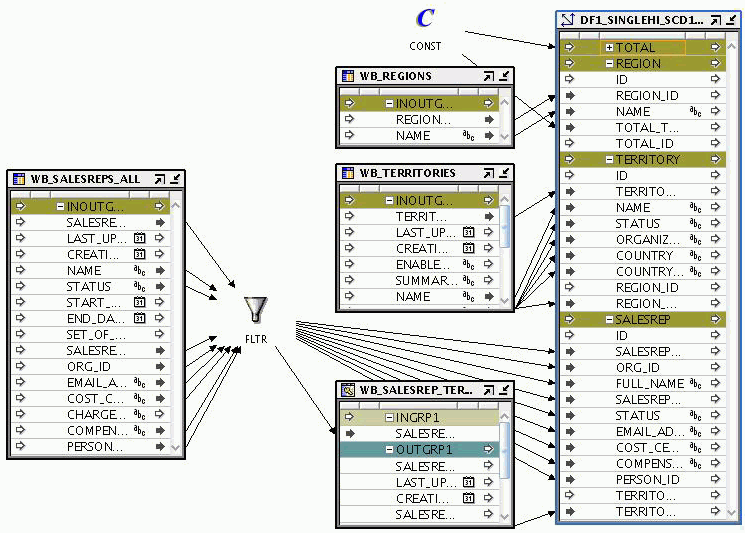

Use the following steps to load the PRODUCTS_TYPE2 Type 2 SCD.
Define a mapping as described in "Defining Mappings".
From the Projects Navigator, drag and drop the PRODUCTS_TYPE2 Type 2 SCD, the Categories_tab table, and the Product_information table onto the mapping canvas.
Set the Loading Type property of the Dimension operator to Load.
Select the Dimension operator on the canvas. The Property Inspector displays the dimension properties. Loading Type is listed under the Dimension Properties node.
Drag and drop a Constant operator used to load the Total level onto the mapping canvas.
Also, add an output attribute called Total_desc to this operator. Set the Expression property of the Total_desc operator to the value that you want assigned to the total_name and total_desc attributes.
Map the attributes from the source operators to the Type 2 SCD.
Figure 6-3 displays the mapping with the source operator mapped to the target. Type 2 SCD.
Figure 6-3 Loading Data Into a Type 2 SCD
Note that, in this example, the effective time of a record is loaded from the source. You can also choose to set this to a default value, such as SYSDATE, using the Default Effective Time of Current Record property.
Because no values are explicitly assigned to the history logging properties, the default values are used.

Use the Dimension operator to remove data from dimensions and SCDs. You create a mapping with the Dimension operator, the source objects containing the data that must be removed from the dimension, and any required transformation operators. Map attributes from the source or transformation operators to the Dimension operator. When the map is executed, the business identifier of the source record is compared to the business identifiers in the dimension. If the business identifiers match, then the corresponding record in the dimension is removed.
To remove data from dimensions or SCDs, set the Loading Type property of the Dimension operator to Remove.
Effect of Surrogate Keys on Dimension Data Removal
When you remove data from a dimension that was created with surrogate keys, parent records of existing children are removed, but child records are left referencing nonexistent parents.
When you remove data from a dimension that was created with no surrogate keys, parent records of existing child records as well as the child records are removed. This is in effect a cascade operation.
The DF1_SINGLEH1_SCD1 is a dimension containing the levels Total, Region, Territory, and Salesrep. This dimension contains existing data that was loaded earlier using another mapping. The tables WBSALESREP_ALL, WB_REGIONS, WB_TERRITORIES, and WBSALESREPTERRITORIES contain the data that must be removed from the various levels in the dimension.
Use the following steps to remove data from the DF1_SINGLEH1_SCD1 dimension.
From the Projects Navigator, drag and drop the DF1_SINGLEH1_SCD1 dimension onto the mapping canvas.
Set the Loading Type property of the Dimension operator to Remove.
From the Projects Navigator, drag and drop the following tables onto the mapping canvas: WBSALESREP_ALL, WB_REGIONS, WB_TERRITORIES, and WBSALESREPTERRITORIES.
Add a Constant operator to the mapping. Create two output attributes ID and Name. To the Expression property of both attributes, assign the values that you want to remove from the Total level.
For example, if you set the Expression attribute of ID to 100 and that of Name to Asia, then all level records, in the Total level, whose ID and Name match these values are deleted. Also, because the ID attribute of the Constant operator is mapped to the Region attribute, all child records of the Total level records that are removed are also removed.
Map the attributes from the source operators to the Dimension operator.
Figure 6-5 displays the mapping with the attributes connected to the Dimension operator.
Figure 6-5 Mapping that Removes Data From a Dimension
The business identifier of the source records is compared to the business identifier of the dimension level record to which it is mapped. If the business identifier matches, then the corresponding record is removed from the dimension.
Validate the mapping by selecting the mapping in the Projects Navigator and clicking Validate on the toolbar.
Resolve errors, if any, that result from the validation process.
Generate the mapping by selecting the mapping in the Projects Navigator and clicking Generate on the toolbar.
The generation results are displayed in a new Results tab in the Log window. Resolve generation errors, if any.
You have now designed a mapping that removes data from a dimension. To actually remove the specified data from the dimension, you must deploy and execute this mapping. For more details about deploying and executing mappings, see "Starting ETL Jobs".
