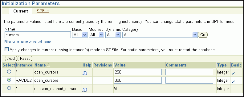

The Current subpage of the Initialization Parameters contains a list of configuration parameters for that instance and database. You can set these parameters to particular values to initialize many of the memory and process settings of an Oracle instance. When you modify initialization parameters using the Current tab, the changes are applied only to the running instances, not the SPFILE, unless the "Apply changes in current running instance(s) mode to SPFile" option is selected.
The Instance column shows the instances for which the parameter has the value listed in the table. An asterisk (*) indicates that the parameter has the same value for all remaining instances of the cluster database. For example, if open_cursors = 250 for node1 and open_cursors = 300 for node2, then the Instance column for open_cursors = 250 displays an asterisk, but the Instance column for open_cursors = 300 contains "node2". This shorthand notation saves space when the cluster databases has many instances.
You can filter the Initialization Parameters page to show only those parameters that meet the criteria of the filter you enter in the Filter by name field. Optionally, you can select Show All to display on one page all parameters currently used by the running instance(s).
To modify parameter values using the Current tab:
Select a parameter from the Select column and do one of the following:
Click Add to add the selected parameter to a different instance.
When the new row appears in the table, choose the instance name to which the new setting applies, and enter the new value for the parameter in the Value field. Optionally, you can put text in the Comment field to indicate why the instance has a different value from the other instances.
Click Reset to reset the value of the selected parameter. Note that using this option you can reset only those parameters that do not have an asterisk in the Instance column.
When you click Reset, the value of the selected parameter is reset to the value of the remaining instances (that is, the row with the asterisk in the Instance column) and the row that has the local instance name in the Instance field is removed from the table.
For example, select the parameter OPEN_CURSORS, then click Add. In the new entry for OPEN_CURSORS, select an Instance (for example sales1 or RACDB2), change the Value field to 300.
After you make changes to one or more of the parameters, click Apply to accept and implement the changes.
You can also add or reset parameters using the SPFile tab. When you modify initialization parameters using the SPFile tab, the changes are applied only to the SPFILE, not the currently running instances, unless the "Apply changes in SPFile mode to the current running instance(s)" option is selected.
Resetting parameters using the SPFile tab is different than resetting the same parameters using the Current tab. You can either reset the parameter value for an instance back to the default value for all instances, or you can delete the default parameter setting (unset the parameter) for all instances.
If you reset a parameter with an asterisk in the Instance column, the entry is deleted from both the SPFILE and the table in Database Control. Only parameters without an asterisk (or instance-specific parameters) remain.
If you reset the only entry for a nonasterisk parameter, it is deleted from both the SPFILE and the table in Database Control, but the parameter is replaced by a dummy parameter with an empty value field and an asterisk in the Instance column; this enables you to specify a new value for the parameter, add new instance-specific entries for the parameter, and so on.
Resetting a parameter that is set for only one instance results in the parameter being unset for all instances.

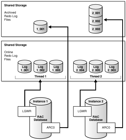

Managing redo log files in Oracle RAC environments is similar to managing redo log files in single-instance Oracle Database environments. This section provides an overview of some of the additional concepts and procedures for configuring redo log files in Oracle RAC environments.
Redo logs contain a record of changes that have been made to data files. In a single-instance Oracle database, redo logs are stored in two or more redo log file groups. Each of these groups contains a redo log file and possibly one or more mirrored copies of that file. In an Oracle RAC database, each instance requires its own set of redo log groups, which is known as a redo thread. Mirrored copies of the redo log files provide your system with extra protection against data loss that is due to hardware failures or data corruption. If a redo log file is unreadable, then the Oracle Database attempts to access its mirrored copy. The redo log file mirrors should be located on different disk devices from the primary redo log files.
Figure 4-1 Illustration of Redo Threads for an Oracle RAC Database
Each instance's redo thread must contain at least two redo log groups. Each redo log group should contain at least two members: a redo log and its mirrored copy. If you create your Oracle RAC database using DBCA, then your Oracle RAC database automatically implements a configuration that meets the Oracle recommendations.
You should create redo log groups only if you are using administrator-managed databases. For policy-managed databases, if an instance starts due to a change in server pool cardinality, then Oracle Database automatically creates redo log files, enables a redo thread for the instance if there is not a redo thread allocated to that instance, and creates the undo tablespace if there is not an undo tablespace allocated to that instance. The database must be using Oracle Managed Files and Oracle ASM in this situation. See Oracle Real Application Clusters Administration and Deployment Guide for more information.
In an Oracle RAC database, all the redo log files reside on shared storage. In addition, each instance must have access to the redo log files of all the other instances in the cluster. If your Oracle RAC database uses Oracle ASM, then Oracle ASM manages the shared storage for the redo log files and the access to those files.
DBCA creates redo threads and undo tablespaces up to the maximum instance parameter at the time of creation for better performance.In an Oracle RAC database, each instance writes and archives the redo log groups in its redo thread in the same manner that single-instance Oracle databases do. However, in recovery mode, the instance performing the recovery can read and process all the redo threads for the database, regardless of which instance generated the redo thread. Being able to read all the redo threads enables a running instance to recover the work completed by one or more failed instances.
In case of instance failure, a surviving instance can read the redo logs of the failed instance. Users can continue to access and update the database without waiting for the failed instance to be restarted. For example, assume that you have an Oracle RAC database with two instances, instance A and instance B. If instance A is down, then instance B can read the redo log files for both instance A and B to ensure a successful recovery.
