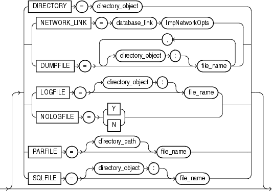

Purpose
Specifies the default location in which the import job can find the dump file set and where it should create log and SQL files.
Syntax and Description
DIRECTORY=directory_object
The directory_object is the name of a database directory object (not the file path of an actual directory). Upon installation, privileged users have access to a default directory object named DATA_PUMP_DIR. Users with access to DATA_PUMP_DIR need not use the DIRECTORY parameter at all.
A directory object specified on the DUMPFILE, LOGFILE, or SQLFILE parameter overrides any directory object that you specify for the DIRECTORY parameter. You must have Read access to the directory used for the dump file set and Write access to the directory used to create the log and SQL files.
Example
The following is an example of using the DIRECTORY parameter. You can create the expfull.dmp dump file used in this example by running the example provided for the Export FULL parameter. See "FULL".
> impdp hr DIRECTORY=dpump_dir1 DUMPFILE=expfull.dmp LOGFILE=dpump_dir2:expfull.log
This command results in the import job looking for the expfull.dmp dump file in the directory pointed to by the dpump_dir1 directory object. The dpump_dir2 directory object specified on the LOGFILE parameter overrides the DIRECTORY parameter so that the log file is written to dpump_dir2.
See Also:
"Default Locations for Dump, Log, and SQL Files" for more information about default directory objects
Oracle Database SQL Language Reference for more information about the CREATE DIRECTORY command
Default: expdat.dmp
Purpose
Specifies the names and optionally, the directory objects of the dump file set that was created by Export.
DUMPFILE=[directory_object:]file_name [, ...]
The directory_object is optional if one has already been established by the DIRECTORY parameter. If you do supply a value here, then it must be a directory object that already exists and that you have access to. A database directory object that is specified as part of the DUMPFILE parameter overrides a value specified by the DIRECTORY parameter.
The file_name is the name of a file in the dump file set. The file names can also be templates that contain the substitution variable, %U. If %U is used, then Import examines each file that matches the template (until no match is found) to locate all files that are part of the dump file set. The %U expands to a 2-digit incrementing integer starting with 01.
Sufficient information is contained within the files for Import to locate the entire set, provided the file specifications in the DUMPFILE parameter encompass the entire set. The files are not required to have the same names, locations, or order that they had at export time.
Example
The following is an example of using the Import DUMPFILE parameter. You can create the dump files used in this example by running the example provided for the Export DUMPFILE parameter. See "DUMPFILE".
> impdp hr DIRECTORY=dpump_dir1 DUMPFILE=dpump_dir2:exp1.dmp, exp2%U.dmp
Because a directory object (dpump_dir2) is specified for the exp1.dmp dump file, the import job will look there for the file. It will also look in dpump_dir1 for dump files of the form exp2nn.dmp. The log file will be written to dpump_dir1.
Default: There is no default; the value is user-supplied.

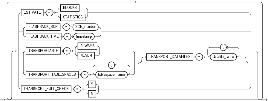

Default: BLOCKS
Purpose
Instructs the source system in a network import operation to estimate how much data will be generated.
ESTIMATE={BLOCKS | STATISTICS}
The valid choices for the ESTIMATE parameter are as follows:
BLOCKS - The estimate is calculated by multiplying the number of database blocks used by the source objects times the appropriate block sizes.
STATISTICS - The estimate is calculated using statistics for each table. For this method to be as accurate as possible, all tables should have been analyzed recently.
The estimate that is generated can be used to determine a percentage complete throughout the execution of the import job.
Restrictions
The Import ESTIMATE parameter is valid only if the NETWORK_LINK parameter is also specified.
When the import source is a dump file set, the amount of data to be loaded is already known, so the percentage complete is automatically calculated.
The estimate may be inaccurate if the QUERY, SAMPLE, or REMAP_DATA parameter is used.
Example
In the following example, source_database_link would be replaced with the name of a valid link to the source database.
> impdp hr TABLES=job_history NETWORK_LINK=source_database_link
DIRECTORY=dpump_dir1 ESTIMATE=statistics
The job_history table in the hr schema is imported from the source database. A log file is created by default and written to the directory pointed to by the dpump_dir1 directory object. When the job begins, an estimate for the job is calculated based on table statistics.

Purpose
Specifies the system change number (SCN) that Import will use to enable the Flashback utility.
FLASHBACK_SCN=scn_number
The import operation is performed with data that is consistent as of the specified scn_number.
If you are on a logical standby system, then theFLASHBACK_SCN parameter is ignored because SCNs are selected by logical standby. See Oracle Data Guard Concepts and Administration for information about logical standby databases.Restrictions
The FLASHBACK_SCN parameter is valid only when the NETWORK_LINK parameter is also specified.
The FLASHBACK_SCN parameter pertains only to the Flashback Query capability of Oracle Database. It is not applicable to Flashback Database, Flashback Drop, or Flashback Data Archive.
FLASHBACK_SCN and FLASHBACK_TIME are mutually exclusive.
Example
The following is an example of using the FLASHBACK_SCN parameter.
> impdp hr DIRECTORY=dpump_dir1 FLASHBACK_SCN=123456 NETWORK_LINK=source_database_link
The source_database_link in this example would be replaced with the name of a source database from which you were importing data.
Purpose
FLASHBACK_TIME="TO_TIMESTAMP()"
The SCN that most closely matches the specified time is found, and this SCN is used to enable the Flashback utility. The import operation is performed with data that is consistent as of this SCN. Because the TO_TIMESTAMP value is enclosed in quotation marks, it would be best to put this parameter in a parameter file. See "Use of Quotation Marks On the Data Pump Command Line".
If you are on a logical standby system, then theFLASHBACK_TIME parameter is ignored because SCNs are selected by logical standby. See Oracle Data Guard Concepts and Administration for information about logical standby databases.Restrictions
This parameter is valid only when the NETWORK_LINK parameter is also specified.
The FLASHBACK_TIME parameter pertains only to the flashback query capability of Oracle Database. It is not applicable to Flashback Database, Flashback Drop, or Flashback Data Archive.
FLASHBACK_TIME and FLASHBACK_SCN are mutually exclusive.
Example
You can specify the time in any format that the DBMS_FLASHBACK.ENABLE_AT_TIME procedure accepts,. For example, suppose you have a parameter file, flashback_imp.par, that contains the following:
FLASHBACK_TIME="TO_TIMESTAMP('25-08-2008 14:35:00', 'DD-MM-YYYY HH24:MI:SS')"
You could then issue the following command:
> impdp hr DIRECTORY=dpump_dir1 PARFILE=flashback_imp.par NETWORK_LINK=source_database_link
The import operation will be performed with data that is consistent with the SCN that most closely matches the specified time.
See Also:
Oracle Database Advanced Application Developer's Guide for information about using flashbackDefault: Y

> impdp hr TABLES=employees DIRECTORY=dpump_dir1
NETWORK_LINK=source_database_link EXCLUDE=CONSTRAINT
This example results in an import of the employees table (excluding constraints) from the source database. The log file is written to dpump_dir1, specified on the DIRECTORY parameter.
Default: n
Purpose
Specifies whether to suppress the default behavior of creating a log file.
NOLOGFILE={y | n}
If you specify NOLOGFILE=y to suppress creation of a log file, then progress and error information is still written to the standard output device of any attached clients, including the client that started the original export operation. If there are no clients attached to a running job and you specify NOLOGFILE=y, then you run the risk of losing important progress and error information.
Example
The following is an example of using the NOLOGFILE parameter.
> impdp hr DIRECTORY=dpump_dir1 DUMPFILE=expfull.dmp NOLOGFILE=y
This command results in a full mode import (the default for file-based imports) of the expfull.dmp dump file. No log file is written because NOLOGFILE is set to y.

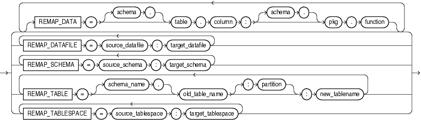

REMAP_DATA=[schema.]tablename.column_name:[schema.]pkg.function
The description of each syntax element, in the order in which they appear in the syntax, is as follows:
schema -- the schema containing the table to be remapped. By default, this is the schema of the user doing the import.
tablename -- the table whose column will be remapped.
column_name -- the column whose data is to be remapped. The maximum number of columns that can be remapped for a single table is 10.
schema -- the schema containing the PL/SQL package you created that contains the remapping function. As a default, this is the schema of the user doing the import.
pkg -- the name of the PL/SQL package you created that contains the remapping function.
function -- the name of the function within the PL/SQL that will be called to remap the column table in each row of the specified table.
Restrictions
The datatypes of the source argument and the returned value should both match the datatype of the designated column in the table.
Remapping functions should not perform commits or rollbacks except in autonomous transactions.
The maximum number of columns you can remap on a single table is 10. You can remap 9 columns on table a and 8 columns on table b, and so on, but the maximum for each table is 10.
Example
The following example assumes a package named remap has been created that contains a function named plusx that changes the values for first_name in the employees table.
> impdp hr DIRECTORY=dpump_dir1 DUMPFILE=expschema.dmp TABLES=hr.employees REMAP_DATA=hr.employees.first_name:hr.remap.plusx

REMAP_DATAFILE=source_datafile:target_datafile
Remapping data files is useful when you move databases between platforms that have different file naming conventions. The source_datafile and target_datafile names should be exactly as you want them to appear in the SQL statements where they are referenced. Oracle recommends that you enclose data file names in quotation marks to eliminate ambiguity on platforms for which a colon is a valid file specification character.
Depending on your operating system, the use of quotation marks when you specify a value for this parameter may also require that you use escape characters. Oracle recommends that you place this parameter in a parameter file, which can reduce the number of escape characters that might otherwise be needed on the command line.
You must have the DATAPUMP_IMP_FULL_DATABASE role to specify this parameter.
Example
Suppose you had a parameter file, payroll.par, with the following content:
DIRECTORY=dpump_dir1 FULL=Y DUMPFILE=db_full.dmp REMAP_DATAFILE="'DB1$:[HRDATA.PAYROLL]tbs6.dbf':'/db1/hrdata/payroll/tbs6.dbf'"
You can then issue the following command:
> impdp hr PARFILE=payroll.par
This example remaps a VMS file specification (DR1$:[HRDATA.PAYROLL]tbs6.dbf) to a UNIX file specification, (/db1/hrdata/payroll/tbs6.dbf) for all SQL DDL statements during the import. The dump file, db_full.dmp, is located by the directory object, dpump_dir1.

REMAP_SCHEMA=source_schema:target_schema
Multiple REMAP_SCHEMA lines can be specified, but the source schema must be different for each one. However, different source schemas can map to the same target schema. The mapping may not be 100 percent complete, because there are certain schema references that Import is not capable of finding. For example, Import will not find schema references embedded within the body of definitions of types, views, procedures, and packages.
If the schema you are remapping to does not already exist, then the import operation creates it, provided that the dump file set contains the necessary CREATE USER metadata for the source schema, and provided that you are importing with enough privileges. For example, the following Export commands create dump file sets with the necessary metadata to create a schema, because the user SYSTEM has the necessary privileges:
> expdp system SCHEMAS=hr Password: password > expdp system FULL=y Password: password
If your dump file set does not contain the metadata necessary to create a schema, or if you do not have privileges, then the target schema must be created before the import operation is performed. This is because the unprivileged dump files do not contain the necessary information for the import to create the schema automatically.
If the import operation does create the schema, then after the import is complete, you must assign it a valid password to connect to it. The SQL statement to do this, which requires privileges, is:
SQL> ALTER USER schema_name IDENTIFIED BY new_password
Restrictions
Unprivileged users can perform schema remaps only if their schema is the target schema of the remap. (Privileged users can perform unrestricted schema remaps.)
For example, SCOTT can remap his BLAKE's objects to SCOTT, but SCOTT cannot remap SCOTT's objects to BLAKE.
Example
Suppose that, as user SYSTEM, you execute the following Export and Import commands to remap the hr schema into the scott schema:
> expdp system SCHEMAS=hr DIRECTORY=dpump_dir1 DUMPFILE=hr.dmp > impdp system DIRECTORY=dpump_dir1 DUMPFILE=hr.dmp REMAP_SCHEMA=hr:scott
In this example, if user scott already exists before the import, then the Import REMAP_SCHEMA command will add objects from the hr schema into the existing scott schema. You can connect to the scott schema after the import by using the existing password (without resetting it).
If user scott does not exist before you execute the import operation, then Import automatically creates it with an unusable password. This is possible because the dump file, hr.dmp, was created by SYSTEM, which has the privileges necessary to create a dump file that contains the metadata needed to create a schema. However, you cannot connect to scott on completion of the import, unless you reset the password for scott on the target database after the import completes.

REMAP_TABLE=[schema.]old_tablename[.partition]:new_tablename
OR
REMAP_TABLE=[schema.]old_tablename[:partition]:new_tablename
You can use the REMAP_TABLE parameter to rename entire tables or to rename table partitions if the table is being departitioned. (See "PARTITION_OPTIONS".)
You can also use it to override the automatic naming of table partitions that were exported.
Usage Notes
Be aware that with the first syntax, if you specify REMAP_TABLE=A.B:C, then Import assumes that A is a schema name, B is the old table name, and C is the new table name. To use the first syntax to rename a partition that is being promoted to a nonpartitioned table, you must specify a schema name.
To use the second syntax to rename a partition being promoted to a nonpartitioned table, you only need to qualify it with the old table name. No schema name is required.
Restrictions
Only objects created by the Import will be remapped. In particular, preexisting tables will not be remapped.
The REMAP_TABLE parameter will not work if the table being remapped has named constraints in the same schema and the constraints need to be created when the table is created.
Example
The following is an example of using the REMAP_TABLE parameter to rename the employees table to a new name of emps:
> impdp hr DIRECTORY=dpump_dir1 DUMPFILE=expschema.dmp TABLES=hr.employees REMAP_TABLE=hr.employees:emps

REMAP_TABLESPACE=source_tablespace:target_tablespace
Multiple REMAP_TABLESPACE parameters can be specified, but no two can have the same source tablespace. The target schema must have sufficient quota in the target tablespace.
Note that use of the REMAP_TABLESPACE parameter is the only way to remap a tablespace in Data Pump Import. This is a simpler and cleaner method than the one provided in the original Import utility. That method was subject to many restrictions (including the number of tablespace subclauses) which sometimes resulted in the failure of some DDL commands.
By contrast, the Data Pump Import method of using the REMAP_TABLESPACE parameter works for all objects, including the user, and it works regardless of how many tablespace subclauses are in the DDL statement.
Restrictions
Data Pump Import can only remap tablespaces for transportable imports in databases where the compatibility level is set to 10.1 or later.
Only objects created by the Import will be remapped. In particular, the tablespaces for preexisting tables will not be remapped if TABLE_EXISTS_ACTION is set to SKIP, TRUNCATE, or APPEND.
Example
The following is an example of using the REMAP_TABLESPACE parameter.
> impdp hr REMAP_TABLESPACE=tbs_1:tbs_6 DIRECTORY=dpump_dir1 DUMPFILE=employees.dmp

Default: NEVER
Purpose
Specifies whether the transportable option should be used during a table mode import (specified with the TABLES parameter) to import only metadata for specific tables, partitions, and subpartitions.
TRANSPORTABLE = {ALWAYS | NEVER}
The definitions of the allowed values are as follows:
ALWAYS - Instructs the import job to use the transportable option. If transportable is not possible, then the job will fail. The transportable option imports only metadata for the specified tables, partitions, or subpartitions specified by the TABLES parameter. You must copy the actual data files to the target database. See "Using Data File Copying to Move Data".
NEVER - Instructs the import job to use either the direct path or external table method to load data rather than the transportable option. This is the default.
If only a subset of a table's partitions are imported and the TRANSPORTABLE=ALWAYS parameter is used, then each partition becomes a non-partitioned table.
If only a subset of a table's partitions are imported and the TRANSPORTABLE parameter is not used or is set to NEVER (the default), then:
If PARTITION_OPTIONS=DEPARTITION is used, then each partition is created as a non-partitioned table.
If PARTITION_OPTIONS is not used, then the complete table is created. That is, all the metadata for the complete table is present so that the table definition looks the same on the target system as it did on the source. But only the data for the specified partitions is inserted into the table.
Restrictions
The Import TRANSPORTABLE parameter is valid only if the NETWORK_LINK parameter is also specified.
The TRANSPORTABLE parameter is only valid in table mode imports (the tables do not have to be partitioned or subpartitioned).
The schema performing a transportable import requires the DATAPUMP_EXP_FULL_DATABASE role on the source database and the DATAPUMP_IMP_FULL_DATABASE role on the target database.
To make full use of the TRANSPORTABLE parameter, the COMPATIBLE initialization parameter must be set to at least 11.0.0.
Example
The following example shows the use of the TRANSPORTABLE parameter during a network link import.
> impdp system TABLES=hr.sales TRANSPORTABLE=always
DIRECTORY=dpump_dir1 NETWORK_LINK=dbs1 PARTITION_OPTIONS=departition

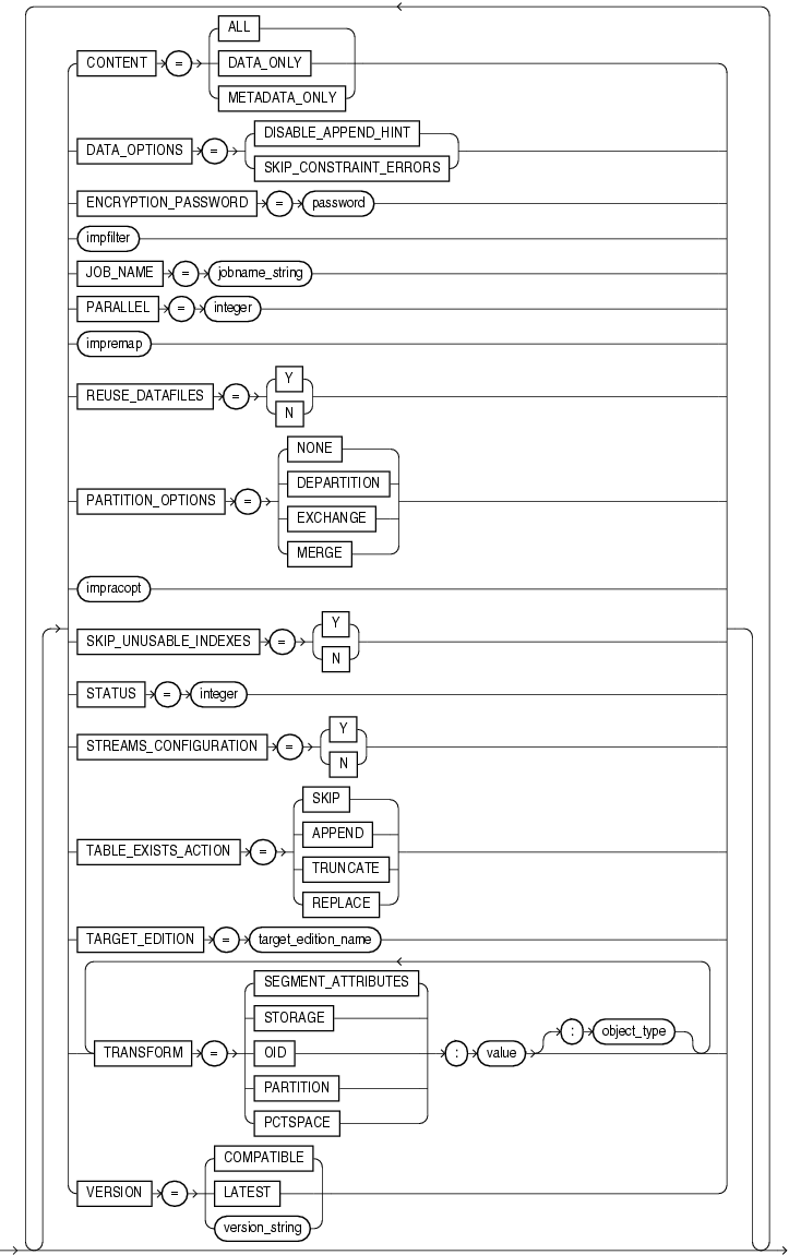

ImpInit
ImpStart
ImpModes
ImpOpts
