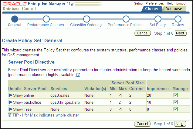

On the first page of the Create Policy Set wizard, check the Manage box next to the server pools that represent your database, for example, online and backoffice. Click Next.
At this point, to get started with Oracle Database QoS Management, accept the defaults for your initial configuration and click Next on each page of the wizard to use the Default Policy Settings. On the fifth step, click Set Policy to set the DefaultPolicy as the Chosen Active Policy, then click Next.
