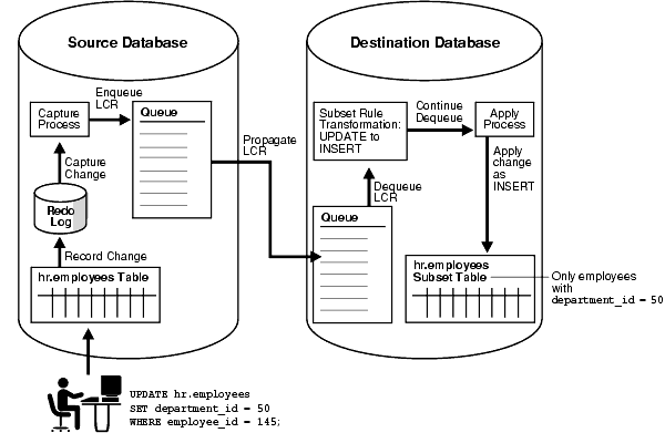

Figure 5-2 Row Migration During Capture by a Capture Process
Similarly, if a captured update changes an employee's department_id from 50 to 20, then a capture process or synchronous capture with this subset rule converts the update operation into a DELETE operation.

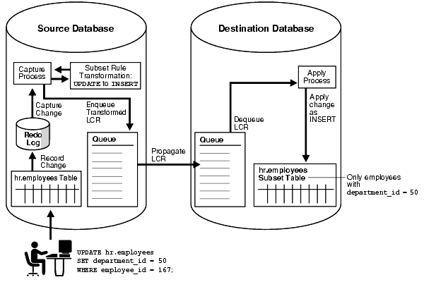

When a subset rule is in the rule set for a propagation, an update operation can be converted into an insert or delete operation when a row LCR is propagated.
For example, suppose you use a subset rule to specify that a propagation propagates changes to the hr.employees table where the employee's department_id is 50 using the following subset condition: department_id = 50. If the source queue for the propagation contains a row LCR with an update operation on the hr.employees table that changes an employee's department_id from 50 to 80, then the propagation with the subset rule converts the update operation into a delete operation and propagates the row LCR to the destination queue. Therefore, a row LCR that contains a DELETE is enqueued into the destination queue. Figure 5-3 illustrates this example.

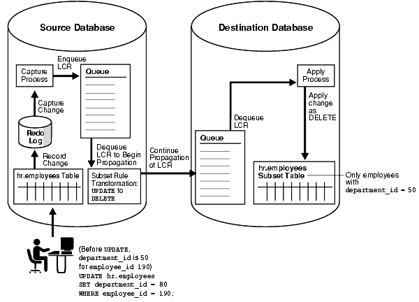

Figure 5-3 Row Migration During Propagation
Similarly, if a captured update changes an employee's department_id from 80 to 50, then a propagation with this subset rule converts the update operation into an INSERT operation.

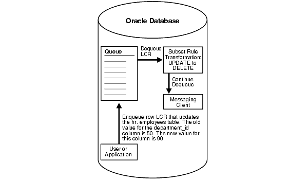

Figure 5-5 Row Migration During Dequeue by a Messaging Client
Similarly, if a persistent row LCR contains an update that changes an employee's department_id from 90 to 50, then a messaging client with this subset rule converts the UPDATE operation into an INSERT operation during dequeue.
