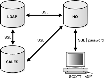

Figure 31-5 illustrates an example of global user security using the enterprise directory service:
Assume that the enterprise directory service contains the following information on enterprise users for hq and sales:

Assume that enterprise user scott requests a connection to local database hq in order to execute a distributed transaction involving sales. The following steps occur (not necessarily in this exact order):
Enterprise user scott is authenticated using SSL or a password.
User scott issues the following statement:
SELECT e.ename, d.loc FROM emp e, dept@sales_link d WHERE e.deptno=d.deptno;
Databases hq and sales mutually authenticate one another using SSL.
Database hq queries the enterprise directory service to determine whether enterprise user scott has access to hq, and discovers scott can access local schema guest using role clerk1.
Database sales queries the enterprise directory service to determine whether enterprise user scott has access to sales, and discovers scott can access local schema guest using role clerk2.
Enterprise user scott logs into sales to schema guest with role clerk2 and issues a SELECT to obtain the required information and transfer it to hq.
Database hq receives the requested data from sales and returns it to the client scott.
