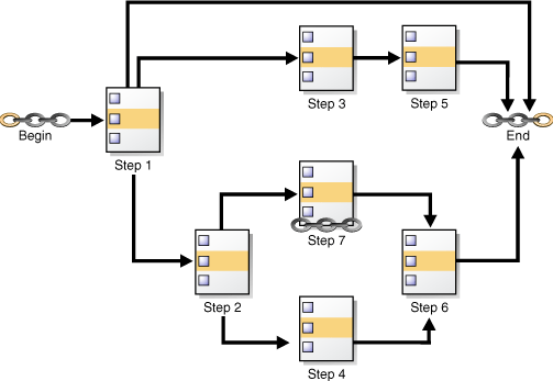

Figure 28-1 shows a chain with multiple branches. In this chain, rules could have been defined as follows:
If Step 1 completes successfully, start Step 2.
If Step 1 fails with error code 20100, start Step 3.
If Step 1 fails with any other error code, end the chain.
Additional rules would govern the running of steps 4, 5, 6, and 7.
While a job pointing to a chain is running, the current state of all steps of the running chain can be monitored. For every step, the Scheduler creates a step job with the same job name and owner as the chain job. Each step job additionally has a step job subname to uniquely identify it. The step job subname is included as the JOB_SUBNAME column in the views *_SCHEDULER_RUNNING_JOBS, *_SCHEDULER_JOB_LOG, and *_SCHEDULER_JOB_RUN_DETAILS, and as the STEP_JOB_SUBNAME column in the *_SCHEDULER_RUNNING_CHAINS views.

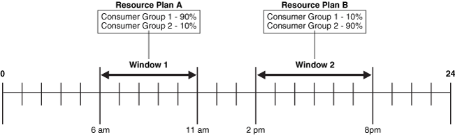

"Creating Job Classes"You typically create windows only when you are in the role of Scheduler administrator.
You create windows to automatically start jobs or to change resource allocation among jobs during various time periods of the day, week, and so on. A window is represented by an interval of time with a well-defined beginning and end, such as "from 12am-6am".
Windows work with job classes to control resource allocation. Each window specifies the resource plan to activate when the window opens (becomes active), and each job class specifies a resource consumer group or specifies a database service, which can map to a consumer group. A job that runs within a window, therefore, has resources allocated to it according to the consumer group of its job class and the resource plan of the window.
Figure 28-2 shows a workday that includes two windows. In this configuration, jobs belonging to the job class that links to Consumer Group 1 get more resources in the morning than in the afternoon. The opposite is true for jobs in the job class that links to Consumer Group 2.
Figure 28-2 Windows help define the resources that are allocated to jobs
See Chapter 27, "Managing Resource Allocation with Oracle Database Resource Manager" for more information on resource plans and consumer groups.
You can assign a priority to each window. If windows overlap, the window with the highest priority is chosen over other windows with lower priorities. The Scheduler automatically opens and closes windows as window start times and end times come and go.
A job can name a window in its schedule_name attribute. The Scheduler then starts the job when the window opens. If a window is already open, and a new job is created that points to that window, the new job does not start until the next time the window opens.
If necessary, you can temporarily block windows from switching the current resource plan. For more information, see "Enabling Oracle Database Resource Manager and Switching Plans", or the discussion of theDBMS_RESOURCE_MANAGER.SWITCH_PLAN package procedure in Oracle Database PL/SQL Packages and Types Reference.See Also:

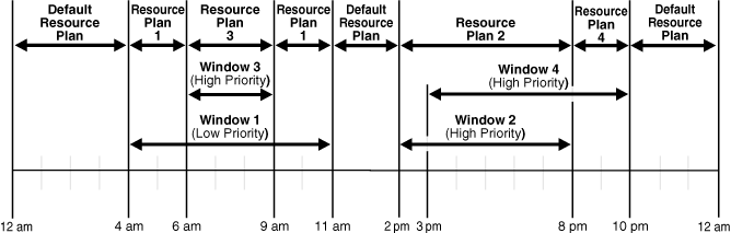

Figure 28-3 illustrates a typical example of how windows, resource plans, and priorities might be determined for a 24 hour schedule. In the following two examples, assume that Window1 has been associated with Resource Plan1, Window2 with Resource Plan2, and so on.
Figure 28-3 Windows and Resource Plans (Example 1)
In Figure 28-3, the following occurs:
From 12AM to 4AM
No windows are open, so a default resource plan is in effect.
From 4AM to 6AM
Window1 has been assigned a low priority, but it opens because there are no high priority windows. Therefore, Resource Plan 1 is in effect.
From 6AM to 9AM
Window3 will open because it has a higher priority than Window1, so Resource Plan 3 is in effect.
From 9AM to 11AM
Even though Window1 was closed at 6AM because of a higher priority window opening, at 9AM, this higher priority window is closed and Window1 still has two hours remaining on its original schedule. It will be reopened for these remaining two hours and resource plan will be in effect.
From 11AM to 2PM
A default resource plan is in effect because no windows are open.
From 2PM to 3PM
Window2 will open so Resource Plan 2 is in effect.
From 3PM to 8PM
Window4 is of the same priority as Window2, so it does not interrupt Window2 and Resource Plan 2 is in effect.
From 8PM to 10PM
Window4 will open so Resource Plan 4 is in effect.
From 10PM to 12AM

When you want a job to run at multiple destinations, you create a database destination group or external destination group and assign it to the destination_name attribute of the job. Specifying a destination group as the destination_name attribute of a job is the only valid way to specify multiple destinations for the job.
You typically create window groups only when you are in the role of Scheduler administrator.
You can group windows for ease of use in scheduling jobs. If a job must run during multiple time periods throughout the day, week, and so on, you can create a window for each time period, and then add the windows to a window group. You can then set the schedule_name attribute of the job to the name of this window group, and the job executes during all the time periods specified by the windows in the window group.
For example, if you had a window called "Weekends" and a window called "Weeknights," you could add these two windows to a window group called "Downtime." The data warehousing staff could then create a job to run queries according to this Downtime window group—on weeknights and weekends—when the queries could be assigned a high percentage of available resources.
If a window in a window group is already open, and a new job is created that points to that window group, the job is not started until the next window in the window group opens.
