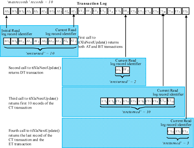

As described in "Retrieving update records from the transaction log", you use the ttXlaNextUpdate or ttXlaNextUpdateWait function to return a batch of records for committed transactions from the transaction log in the order in which they were committed. Each call to ttXlaNextUpdate resets the bookmark's Current Read log record identifier to the last record read, as shown in Figure 5-3. The Current Read log record identifier marks the start position for the next call to ttXlaNextUpdate.
Figure 5-3 Records retrieved by ttXlaNextUpdate

The actual number of records returned by ttXlaNextUpdate or ttXlaNextUpdateWait, as indicated by the nreturned output parameter of those functions, may be less than the value of the maxrecords parameter. Figure 5-6 shows an example where maxrecords is 10, the transaction log contains transaction AT that is made up of seven records, and transaction BT that is made up of three records. In this case, both transactions are returned in the same batch and both maxrecords and nreturned values are 10. However, the next three transactions in the log are CT with 11 records, DT with two records, and ET with two records. Because the commit record for the DT transaction appears before the CT commit record, the next call to ttXlaNextUpdate returns the two records for the DT transaction and the value of nreturned is 2. In the next call to ttXlaNextUpdate, XLA detects that the total records for the CT transaction exceeds maxrecords, so it returns the records for this transaction in two batches. The first batch contains the first 10 records for CT (nreturned = 10). The second batch contains the last CT record and the two records for the ET transaction, assuming no commit record for a transaction following ET is detected within the next seven records.
See "ttXlaNextUpdate" and "ttXlaNextUpdateWait" for details of the parameters of these functions.
Figure 5-6 Records retrieved when maxrecords=10
XLA reads records from either a memory buffer or transaction log files on disk, as described in "How XLA reads records from the transaction log". To minimize latency, records from the memory buffer are returned as soon as they are available, while records not in the buffer are returned only if the buffer is empty. This design allows XLA applications to see changes as soon as the changes are made and with minimal latency. The trade-off is that there may be times when fewer changes are returned than the number requested by the ttXlaNextUpdate or ttXlaNextUpdateWait maxrecords parameter.

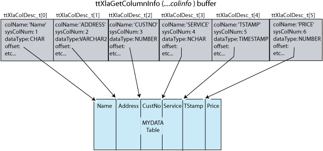

To read the column values from the returned row, you must first know the offset of each column in that row. The column offsets and other column metadata can be obtained for a particular table by calling the ttXlaGetColumnInfo function, which returns a separate ttXlaColDesc_t structure for each column in the table. You should call the ttXlaGetColumnInfo function as part of your initialization procedure. This call was omitted from the discussion in "Initializing XLA and obtaining an XLA handle" for simplicity.
When calling ttXlaGetColumnInfo, specify a colinfo parameter to create a pointer to a buffer to hold the list of returned ttXlaColDesc_t structures. Use the maxcols parameter to define the size of the buffer.
Example 5-5 Using column descriptions
The sample code from the xlaSimple demo below guesses the maximum number of returned columns (MAX_XLA_COLUMNS), which sets the size of the buffer xla_column_defs to hold the returned ttXlaColDesc_t structures. An alternative and more precise way to set the maxcols parameter would be to call the ttXlaGetTableInfo function and use the value returned in ttXlaColDesc_t -> columns.
#define MAX_XLA_COLUMNS 128
SQLINTEGER ncols;
ttXlaColDesc_t xla_column_defs[MAX_XLA_COLUMNS];
rc = ttXlaGetColumnInfo(xla_handle, SYSTEM_TABLE_ID, userID,
xla_column_defs, MAX_XLA_COLUMNS, &ncols);
if (rc != SQL_SUCCESS {
/* See "Handling XLA errors" */
As shown in Figure 5-9, the ttXlaGetColumnInfo function produces the following output:
A list, xla_column_defs, of ttXlaColDesc_t structures into the buffer pointed to by the ttXlaGetColumnInfo colinfo parameter.
An nreturned value, ncols, that holds the actual number of columns returned in the xla_column_defs buffer.
Figure 5-9 ttXlaColDesc_t structures returned by ttXlaGetColumnInfo
Each ttXlaColDesc_t structure returned by ttXlaGetColumnInfo includes an offset value that describes the offset location of that column. How you use this offset value to read the column data depends on whether the column contains fixed-length data (such as CHAR, NCHAR, INTEGER, BINARY, DOUBLE, FLOAT, DATE, TIME, TIMESTAMP, and so on) or variable-length data (such as VARCHAR, NVARCHAR, or VARBINARY).
